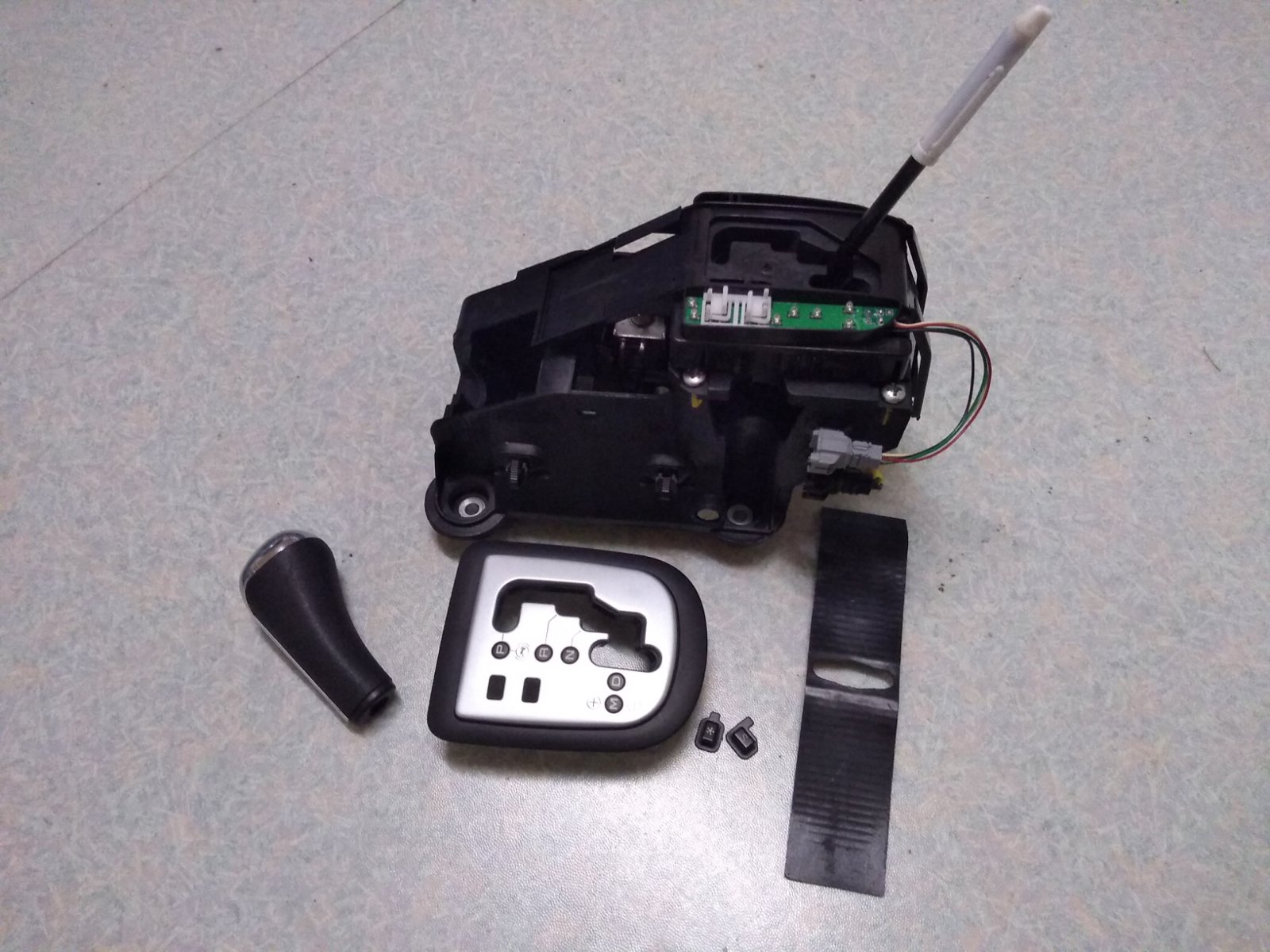

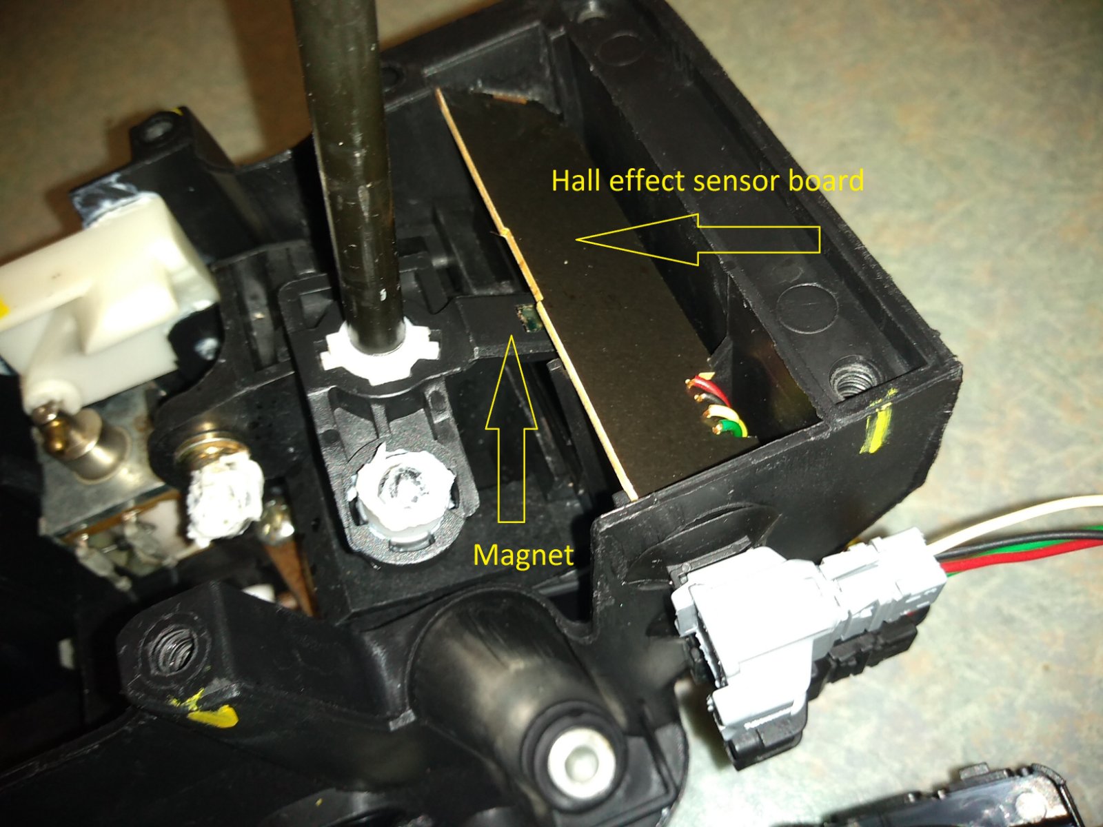

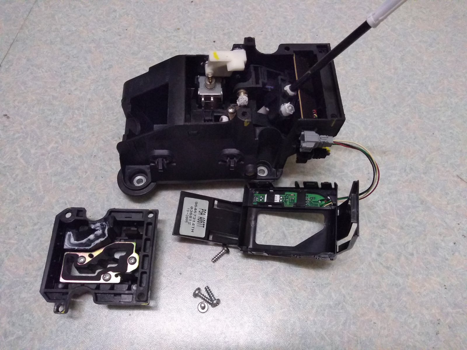

Strip the selector block down.
The magnet is on the selector shaft and the Hall effect sensors are on the bottom of the Printed Circuit Board, at the back of the selector block.
The sensor PCB can be unclipped from the block to get a better look at the magnet.

@ozvtr thanks so much. Actually I’ve noticed this hole. Even tried to place it there but the place is larger than the magnet itself. I will try to put it there in some manner. Pictures are really helpful, appreciate your help =D>
