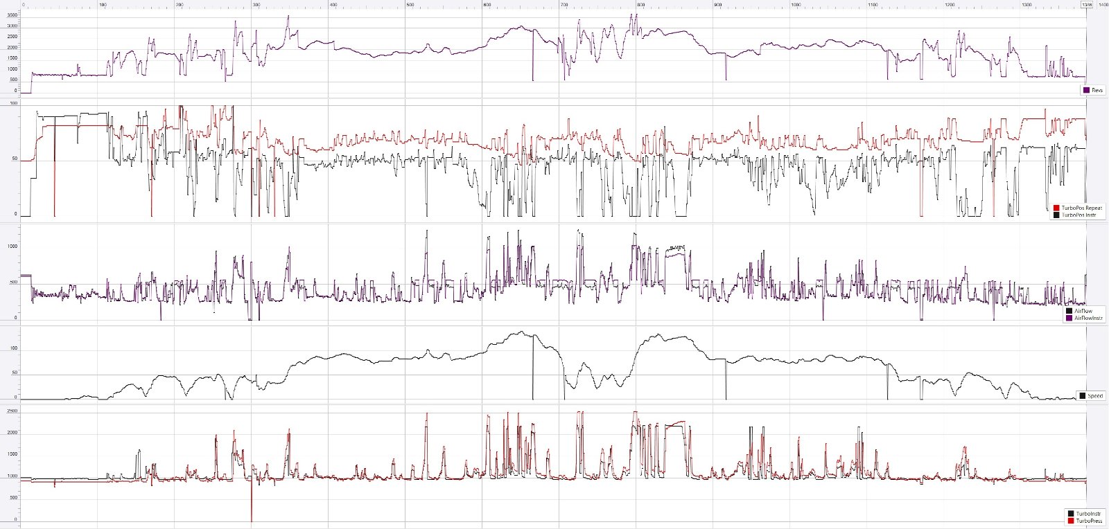

Citroen C5 X7 with VIN VF7**************[VIN obfuscated, can be read by forum staff] is throwing P11AA code mostly when accelerating above 3000 rpm in higher gears. On longer motorway drives it can be joined with P0234.
This is plot of a longish test drive
in better quality
https://postimg.cc/VJGGkS6b
What strikes me is that Turbo Position Repeat starts at 50%, is pretty much constantly above instruction yet there are some random drops towards 0%. Don't know what to make of it though.
