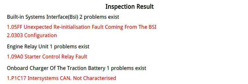

Current Fault codes:
Vehicle information:
Year:2015
Vehicle brand:Peugeot
Model:PARTNER B9
VIN:VF3**************[VIN obfuscated, can be read by forum staff]
Odometer:67534 km
Vehicle Software Version:V10.24

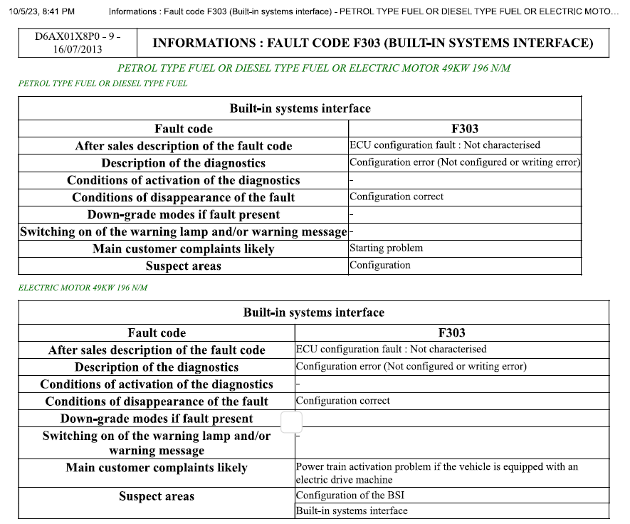

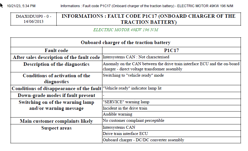

I successfully cleared the P1C17 Intersystems CAN, Not Characterised fault code; however, the remaining codes are still active.
Here's my action plan:
- Hard Reset BSI (viewtopic.php?t=61997)
- Validate that the BSI vehicle configuration aligns with the specified settings. I've already purchased vehicle characteristics from public.servicebox.peugeot.com.
If anyone has some other suggestion to what could cause this behavior is much appreciated.

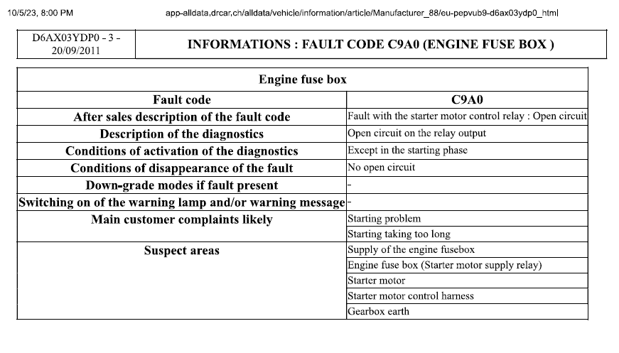

I'm particularly puzzled by the 09A0 Starter Control Relay Fault code, given that this is an electric vehicle.
I do have wiring diagrams and fault code description, but they are pretty vague.
