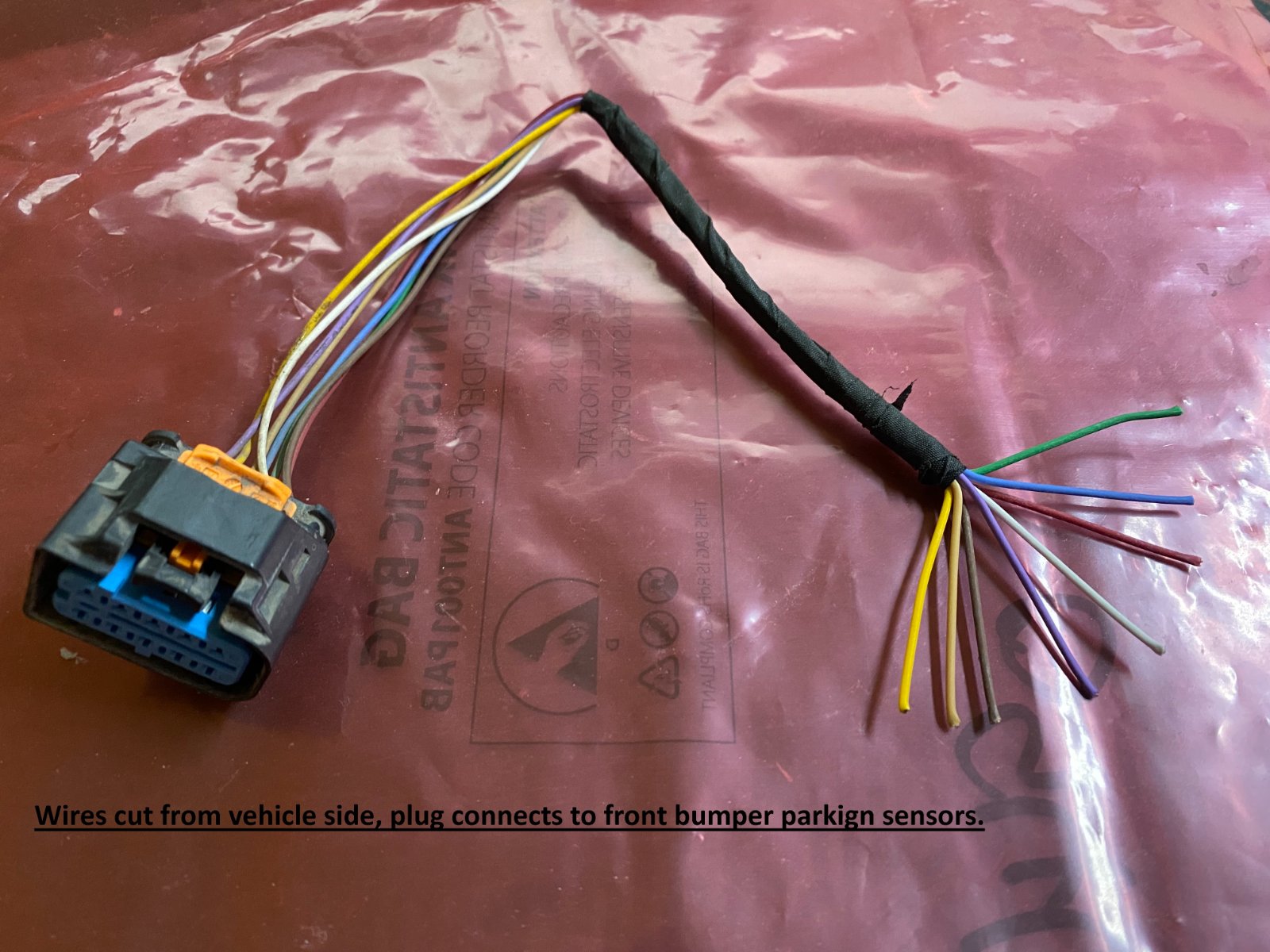

Trying to restore a Wiring loop for Front Parking sensors.

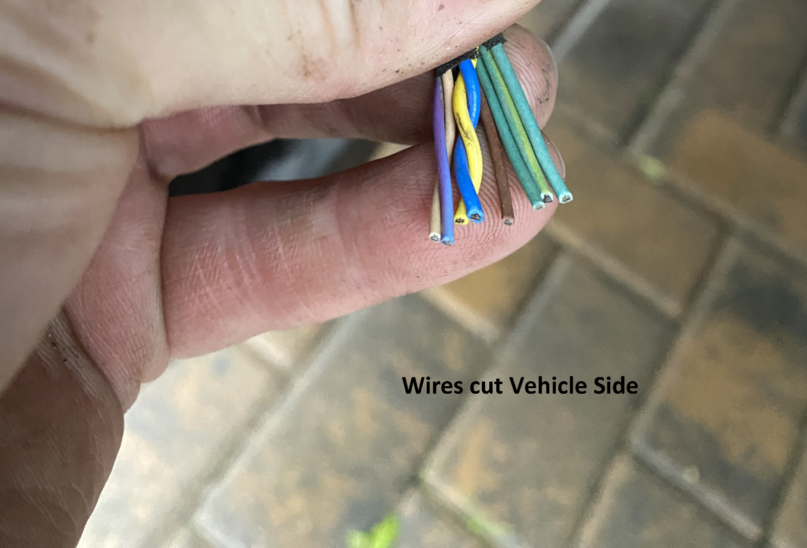

The Plug is cut from the vehicle side, and the plug on the front bumper side is okay.
The wires on the cut loom do not match the colors since I got it from a different vehicle.
Looking for a Pinout of the ECU Part number: 9836031080

Is it possible to get the wiring diagram of that module?
Trying to figure out which wire goes where.

PSA do not always use colours for wiring - do not rely on them as they change. You need to focus on the wiring codes on the sheaths printed every so often.
Wiring diagrams are vehicle specific, and I know I don't have this one.
However, this 2008 diagram with Auto park and front & Rear sensors may assist:
7500 is the Parking Assistance ECU
7507 : front left inner parking assistance sensor /
7509 : front right inner parking assistance sensor /
7518 : front left outer parking assistance sensor /
7519 : front right outer parking assistance sensor /
7516 : front left lateral parking assistance sensor
7517 : front right lateral parking assistance sensor

Thank you for your help, the wires I found were for the Radar.
Found the correct wires and color matched, and all working.
