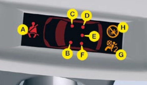

After going through the owners manual, it’s become my assumption that my car does not show this light. It only shows passenger airbag light information on the centre display up by the mirror.

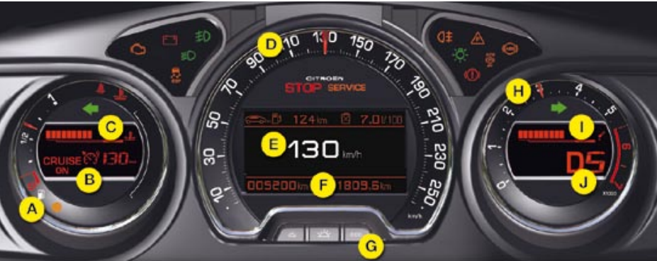

These are the dash lamps of which only some will come on and extinguish after a few seconds - but note there are none for the airbag here.
The only time the airbag light comes on is if the passenger airbag has been switched off with the key, and that is also to be ignored as per the MOT guidance above.
Here are the airbag lamps.
G. Front passenger's airbag deactivation warning lamp.
H. Front passenger's airbag activation warning lamp.
When deactivated, the passenger airbag light 'G', lights up.
He needs to remove that advisory and stick to what he's supposed to be testing and not make it up as he goes along.
On my Aircross, the is a very brief display on the instrument panel of an airbag light - but this warning lamp is not shown on the C5 X7 instrument panel as you can see.
