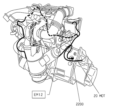

Hi All,
Does anyone know where the Reverse Light switch is located on a C3 Picasso?
Is it connected to a fuse possibly? I have just noticed mine is no longer working (reverse light); I have replaced the bulb but it hasn't made any difference unfortunately and all other lights at the rear are working as intended...

Re: Picasso C3 - Reverse Light Switch Location
It's here as shown by component 2200:
