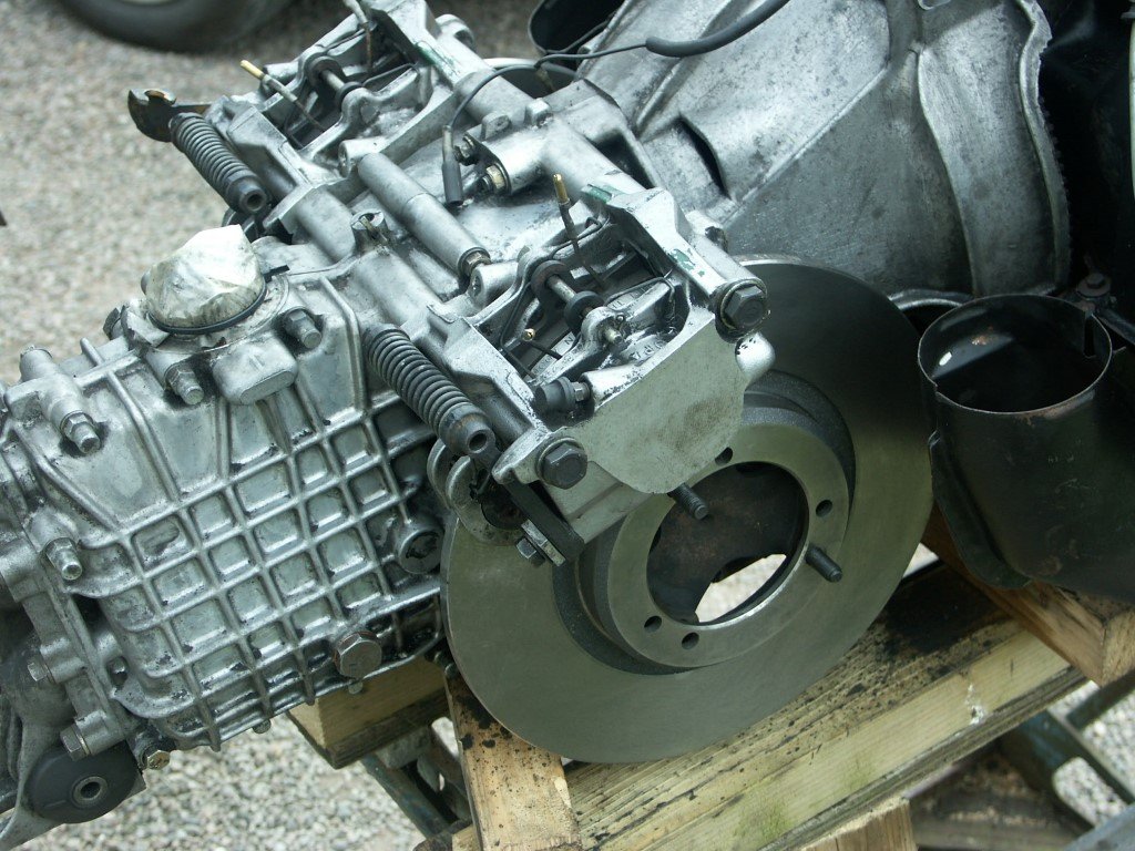

It is absolutely necessary to remove the caliper to remove the disc. But you do not need to remove the parking brake cable. You cannot remove the disc leaving the caliper in situ, it's a physical impossibility.
I can't remember if the trick used on the 2cv is applicable, if so, to save splitting the caliper, one retaining bolt can be removed allowing the caliper to 'rotate' on the remaining retaining bolt (slightly slackened). Then when able, re-insert the removed bolt and tighten. Now remove the other bolt allowing the caliper to be lifted off. Best to release the pressure on the suspension/braking system by cracking the relief valve before starting.
The drive shaft must also be unbolted from the disc.
It's a pig to work on. 'Course, you could whip the whole unit out . . . . Coat.

Except in the case of the 2cv, GS/A, the disc and caliper (front brakes) are not attached to the wheel. They are attached to the gearbox - inboard. Hence they are part of the 'sprung' weight, being of the car, engine, gearbox etc. The wheels of themselves are not of the 'sprung' weight, as they are directly in contact with the road - the 'unspung' part of the vehicle.

It is simple. Instead of braking the wheel directly, the transmission shaft to which the wheel is attached, is braked at its innermost end. Less weight to be bounced up and down at the wheel. The downside is less access, as Richard is finding out!

Yes. Spot the drive shafts/inboard brakes!
Image Image
#-o
A rats nest. Necessitating disconnection of hydraulics, exhaust, cabling etc. Once it's out (and the bumper, front vallance come off easily. The four engine bolts are easy to get at from beneath, but it's so long ago since I did that job - I've forgotten how to access the rear gearbox mount!
Back in, and Tea!
