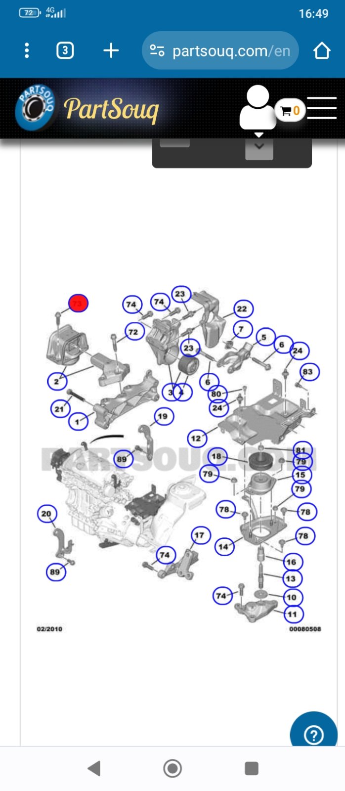

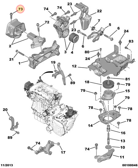

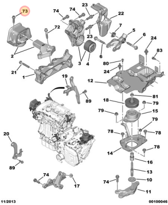

Does anyone know the measurements of the engine mount screws appearing in the attached sketches?
Its a Peugeot 3008 2016 1.6 165 BHP vin VF3**************[VIN obfuscated, can be read by forum staff]

M10 X 1.5mm thread, 45mm long. £6.80 each from Peugeot....

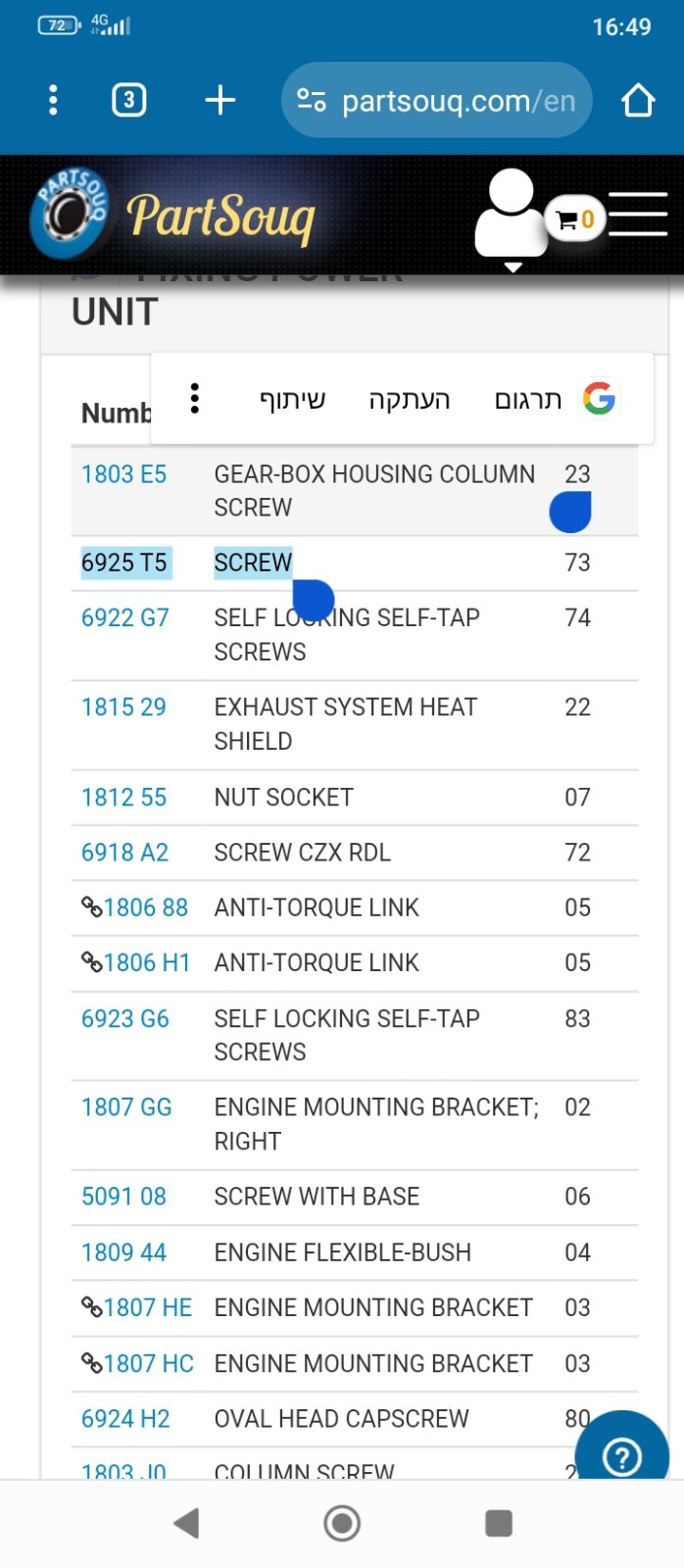

(73) CHC R D L Screw (DIAM 10X150-45), part: 6925T5, supplied in packs of 4 by Peugeot, £6.80
