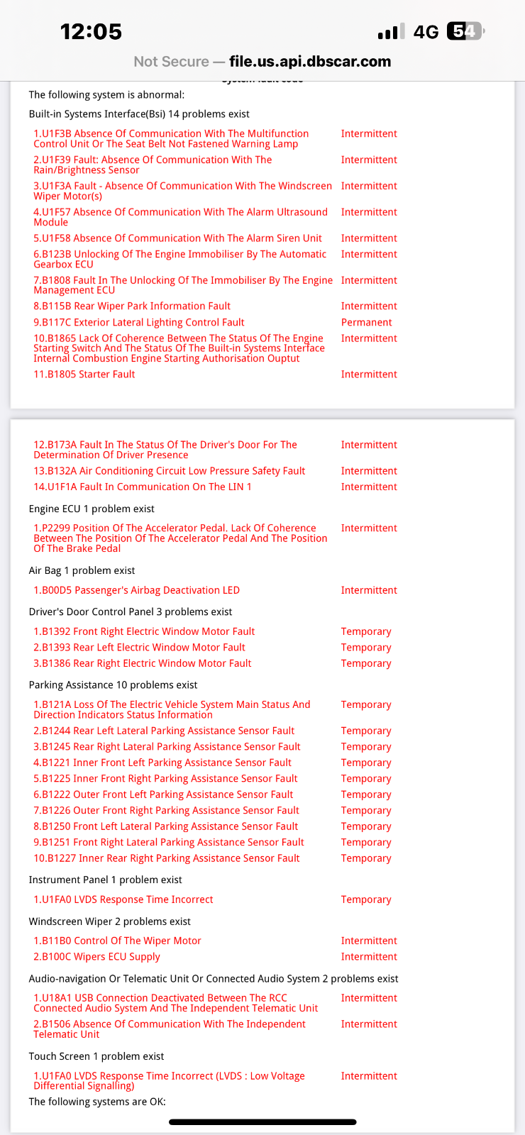

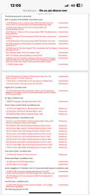

The minor problems, I had the vehicle on a tester for diagnostic and it came up with a few issues which I will post here as picture.

The issues you have are highly unlikely to be the actual sensors or components as the main problems seem to stem from communications faults and when this happens, you can lose contact with various vehicle equipment like the parking sensors, alarm, and other ECUs. There are too many intermittent issues to be sensor failure, so I suspect a CAN wiring fault or possible fusebox issue.
