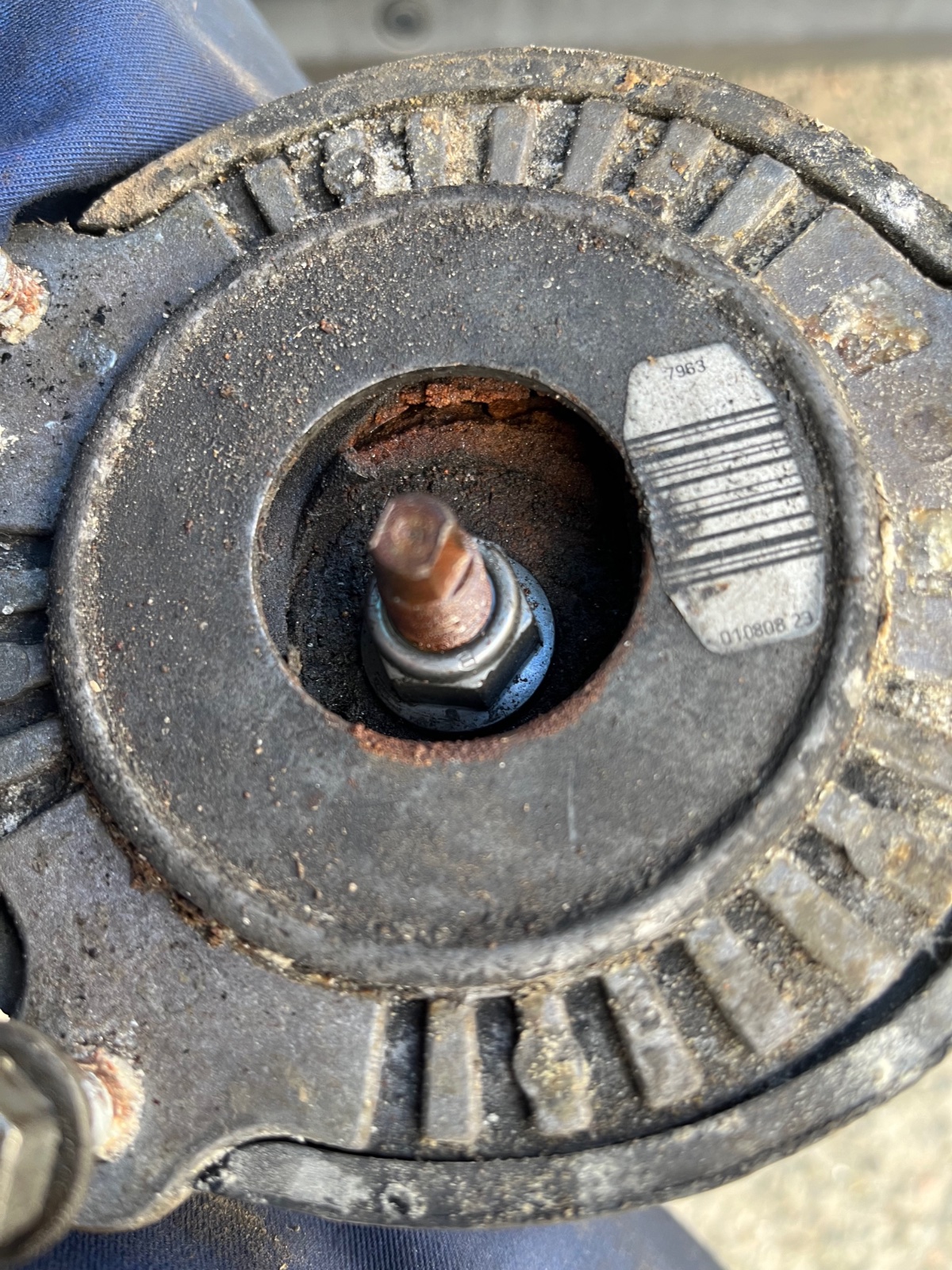

Also strut top rubber is failing so will also replace that.

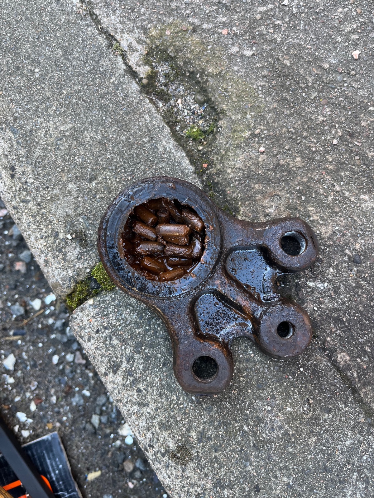

The play I thought was the inner track rod turned out to be the frogs leg thingy (although the inner track rod is not tight like it should be so will put the new one on).
The upper ball joint was fairly worn too although there was no play as such. It was a bugger getting the lock nut off. Broke a Torx bit in half; resorted to Mr Angle Grinder.

Also replaced the top strut mount..
