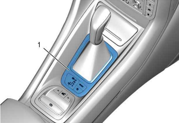

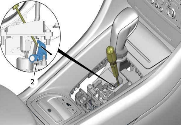

Ok, so this is a shift lock problem. P0928: Fault on the lever locking actuator circuit (shift-lock): Short circuit to positive.
When you can't move from 'P', you need to do the following in order to unlock it temporarily:
Releasing the "shift-lock" (with an operating anomaly)
Impossible to release the "shift-lock" following the usual procedure.
Probable causes of the anomaly
Unclip and move aside: The bezel (1).
Unlock the "shift lock" with the aid of a screwdriver - Press on (2) (In the direction of the arrow ).
Move the selector lever to disengage it from the "P" position.
