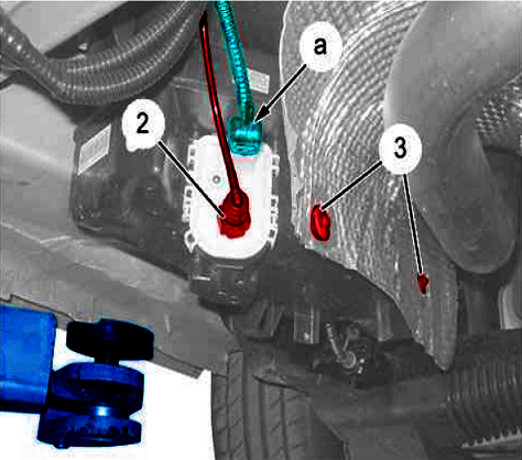

It's here on the rear left but you'll first need to remove the heat shield protection to gain access:

GiveMeABreak wrote: 12 Oct 2023, 17:03 It's here on the rear left but you'll first need to remove the heat shield protection to gain access:
Rear left as in if I’m stood at the back of the car, it will be on my left? I jacked my car up and was taking the undertray off, didn’t look like it was there. I shall look again at the weekend.
x 6945
Re: DS5 paf tank location
Always in the same place - but hidden behind the shielding / protection.
Yes, nearside rear, so your left as you stand behind the car facing the boot. I think that covers it!

GiveMeABreak wrote: 12 Oct 2023, 22:45 Always in the same place - but hidden behind the shielding / protection.
Absolutely, thank you. I was taking the undertray off and wondered why I couldn’t see it. Must be under the heatshield.
