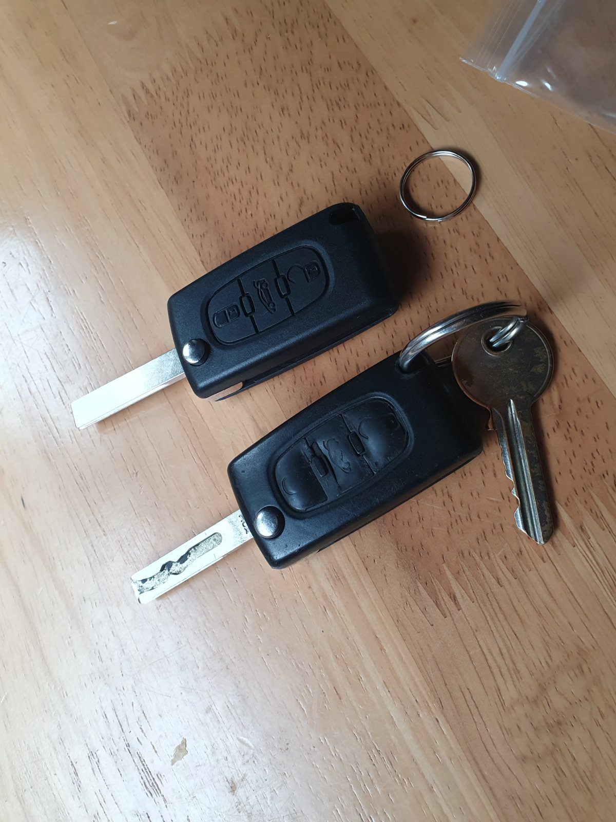

Hi all, it has been a while since I was on. Incredibly the C5 has been entirely trouble free!
I bought a replacement key to replace the original rather worn one and thought I could simply transfer the key blade over to the new remote. However, it is a pattern part and not exactly identical and seems that the key blank must be cut. OK, I'll go to car key cutting places but two I asked can't do it for one reason or another.
Question: has anyone had this type of key cut? any advice - must it be dealer - only or something?
I don't need the remote reprogrammed because the remote board at least is able to swap from the old casing to the new one with the three buttons working fine.

Thanks aspire_helen, I visited an indie key place today and he cut the blank key I gave him using the factory key as the profile. He stated that since the blank was not supplied by himself that there was no guarantee so I accepted on the grounds that my old factory key was actually OK and it was simply the keyfob rubber buttons that are worn and that I simply wanted them replaced. Anyway, I opened the car with the old key, decided to start the engine with the old key (my car tends to sit parked all week until the end of the week) run it for a bit and then turn off to verify all was well. With everything unlocked, I tried the cut key in the ignition and although a bit more 'notchy' to turn it turned on the ignition OK. A warning came up on the display saying anti theft system fault and the engine would not run. New key is not coded to the car. OK though. Tried with original key and the car started as normal. Got out, locked the door manually with the new key and it also unlocked. I locked the doors manually and then returned inside to open each keyfob and then swap over the internal board, chip etc. Success, although I learned how to refit the flip out key blade the hard way.... Returned to the car with the new keyfob that now has the original key internals, unlocked the doors by the new remote, tried the new key in the ignition and it turned again OK but this time the engine started fine because the correct chip in the fob was in the right proximity to the coder. So it looks like it is all ok. Only negative is that the new keyfob had no Citroen chevrons and only had a blank square. It turns out the 15x15mm square logo is also quite available to buy so that's ordered now. Of course I did have a wee prod at the original key logo to see if it might pop out but didn't look like it would without wrecking the badge so that stays in place. So now have a nice feeling, brand new key in my old 17 year old C5..
