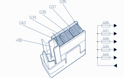

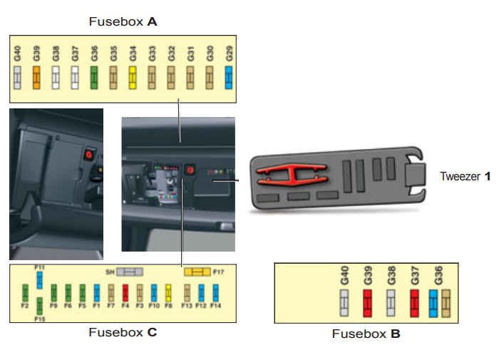

No, not that one Kenny. You're probably thinking of the BCP3 or the BFDB.
BFH1 is one of the cabin fuse boxes, not in the engine bay.
The BSI has fuses, but there are also additional fuse holders surrounding the BSI and one of these is the BFHI:
It contains fuses G36 to G40:
Wolfgang, you will have to look around the BSI area, use a torch (I know it is more difficult on Left Hand Drive vehicles as there isn't much room there), but be careful as there are fuses with duplicate numbers (in fusebox 'A'), but this fuse holder has about 12 fuses, where the one you want in Fusebox 'B' has only 6:
