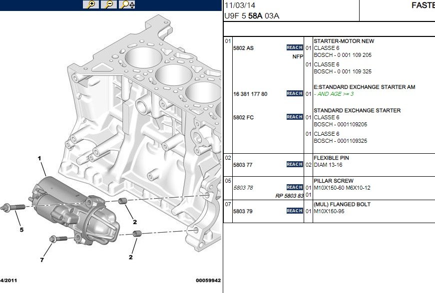

I've checked that the starter fits on the old engine. Could I get a part number for the starter motor from an admin. The vin number is VF3**************[VIN obfuscated, can be read by forum staff]
