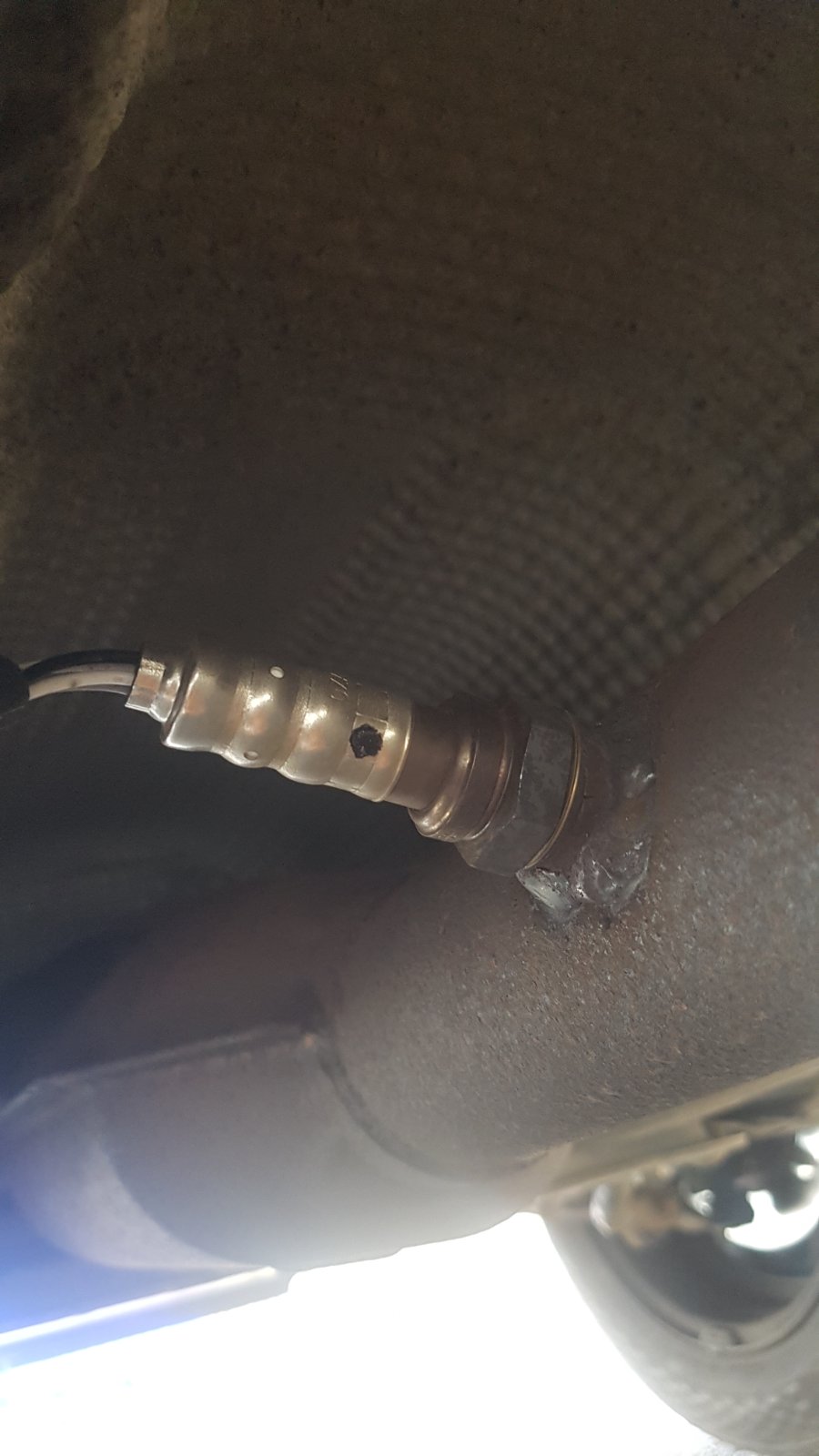

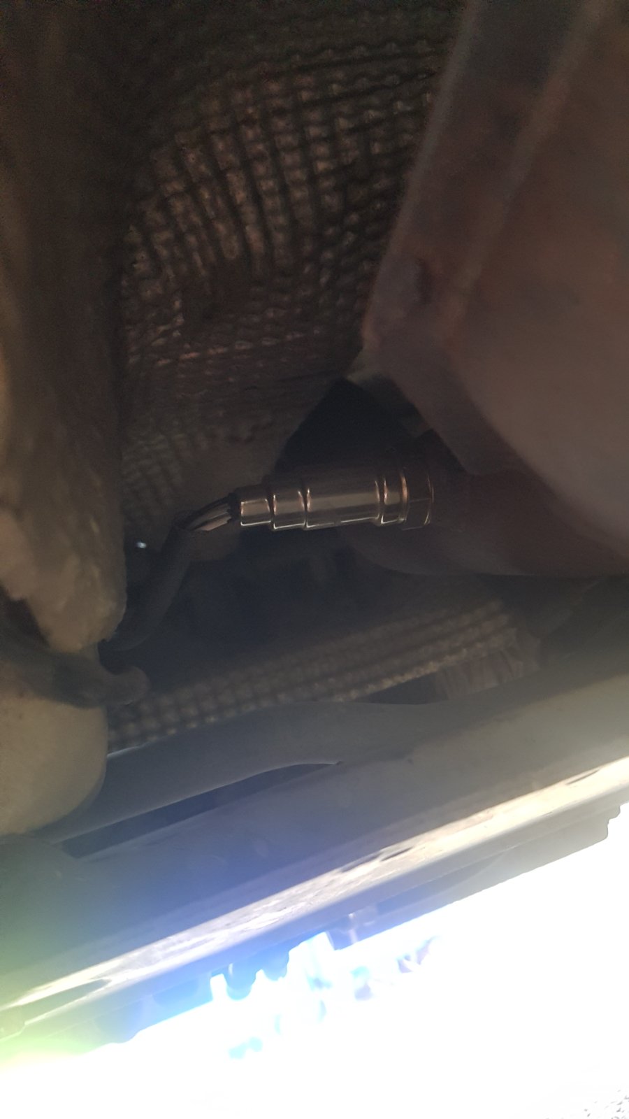

Previous owner did say it has had a new charcoal filter, and looking at it i would agree. Also having been under the car it has had both oxygen sensors replaced recently. Is there anything else i can look for as to what it may be? As looking those codes up those bits pretty much cover it.

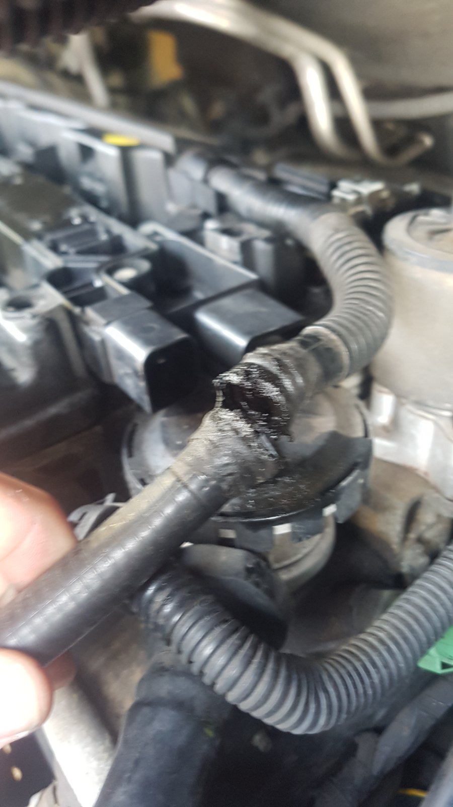

Re: 2001 xsara picasso hesitation.
Found a couple of bits earlier, the coil pack wasnt even bolted in, and i found this lurking once i took the top cover off as well. Its fixed with a temporary fix (gaffer tape) but at this stage so be it.

Charlie715 wrote: 06 Oct 2023, 21:24 Found a couple of bits earlier, the coil pack wasnt even bolted in, and i found this lurking once i took the top cover off as well. Its fixed with a temporary fix (gaffer tape) but at this stage so be it.
Yes, that definitely won't help...

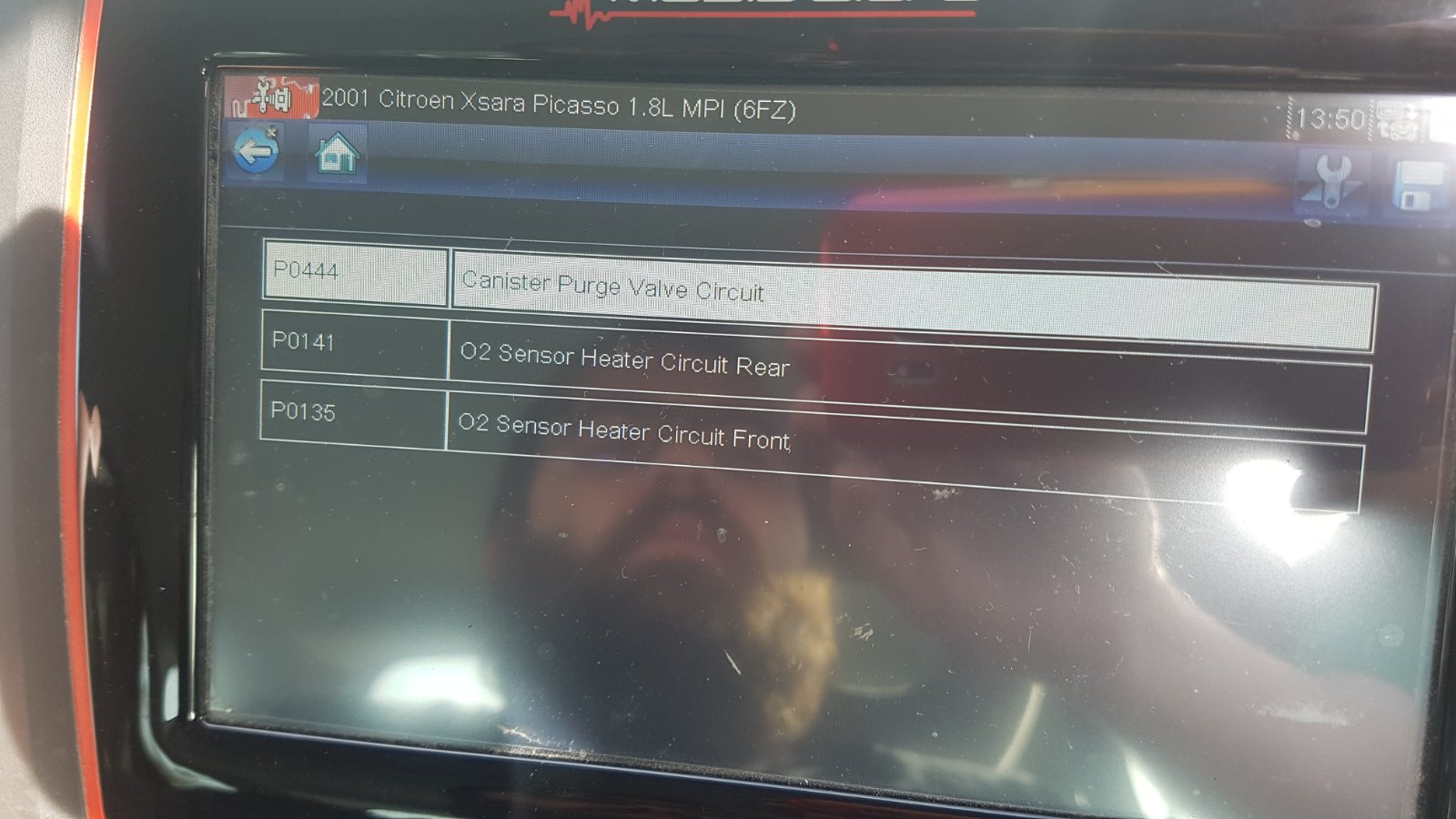

Further update, i cleaned the map sensor and its running a lot better, only 1 bog down all day. However plugged it in again, and these are still coming up.

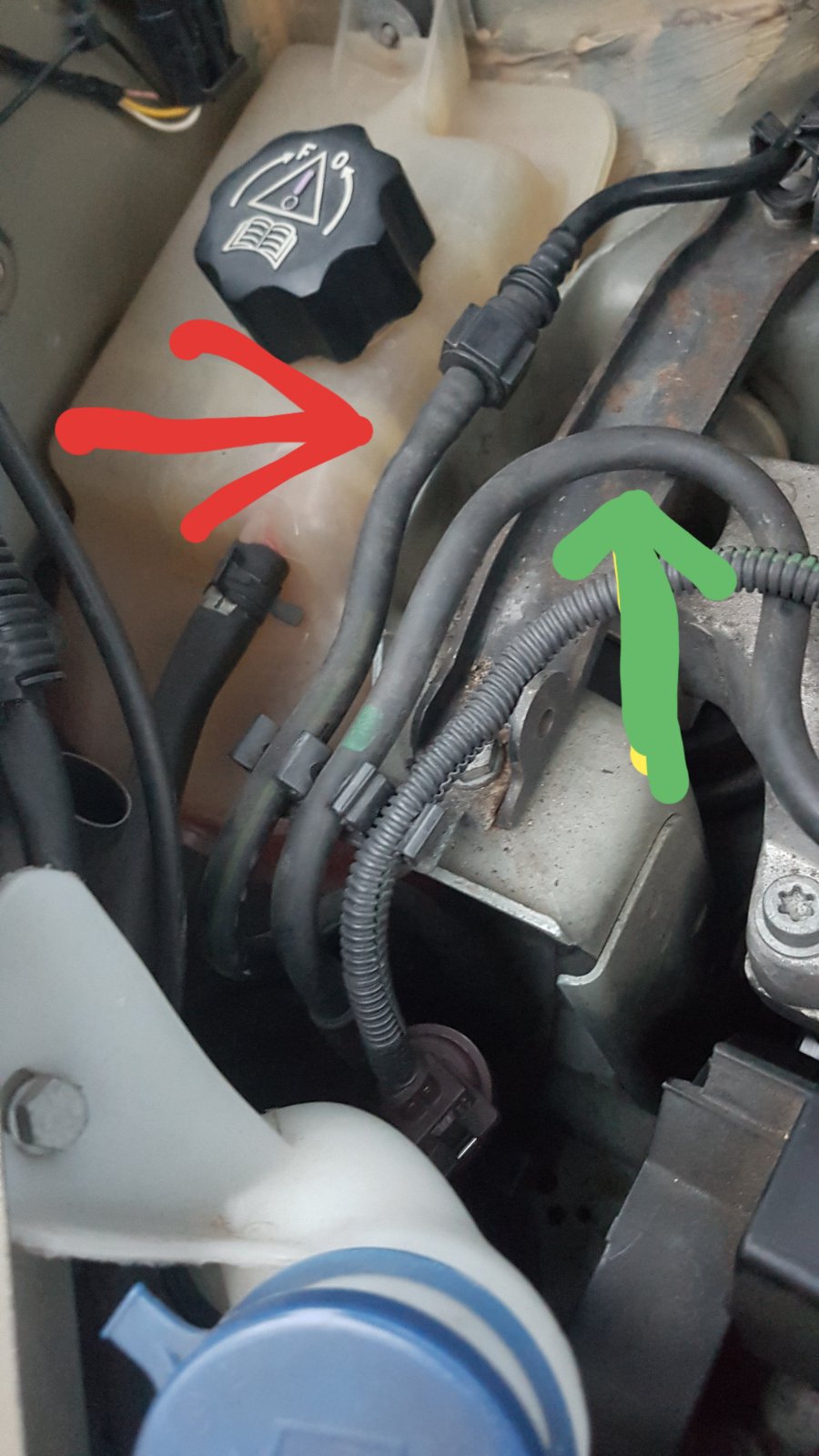

Hi all,
Right i think i'm getting closer, however some on here with vastly more knowledge will tell me otherwise probably.
Have just replaced the fuel filter, which was made in china, and whos contents when i blew it back out into a tray were black.
Checked the pipe arrowed green, from purge valve to inlet, sucking fine towards inlet. However checked red arrowed pipe, from charcoal filter to ? (I assume tank), and nothing. My money is now on dodgy purge valve.

- Posts: 55003
- x 8330
Yes, the purge valve is between the charcoal canister and the top of the fuel tank.
Easy to eliminate, just plug (temporarily) both sides of the purge valve and see if there's any difference...
PaulC5
- Posts: 2575
- Joined: 06 Jun 2023, 15:26
- x 670
Plugging the purge valve might not be as easy as thought, on the Astra I did the pipes to the purge valve were a plastic shrink fit so would not remove without damaging them. Fortunately for the new valve I had some rubber petrol pipe and clips that could be used instead.
