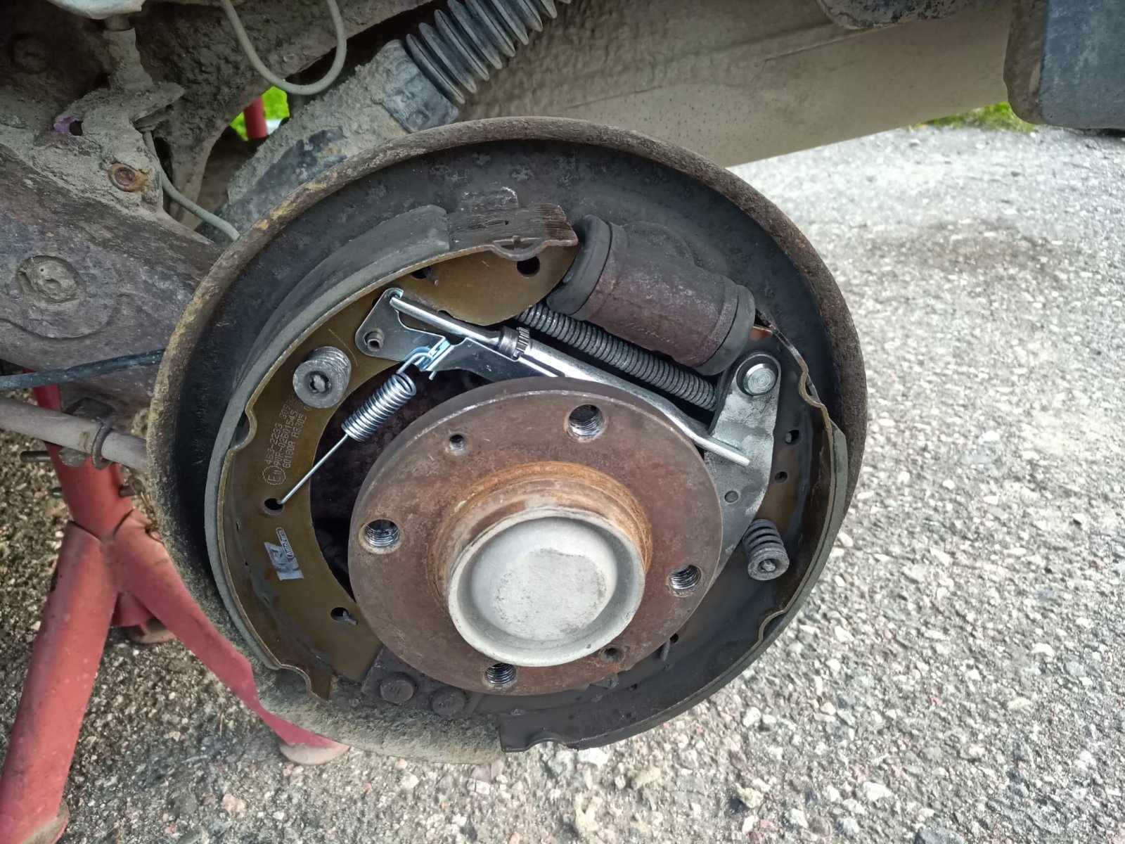

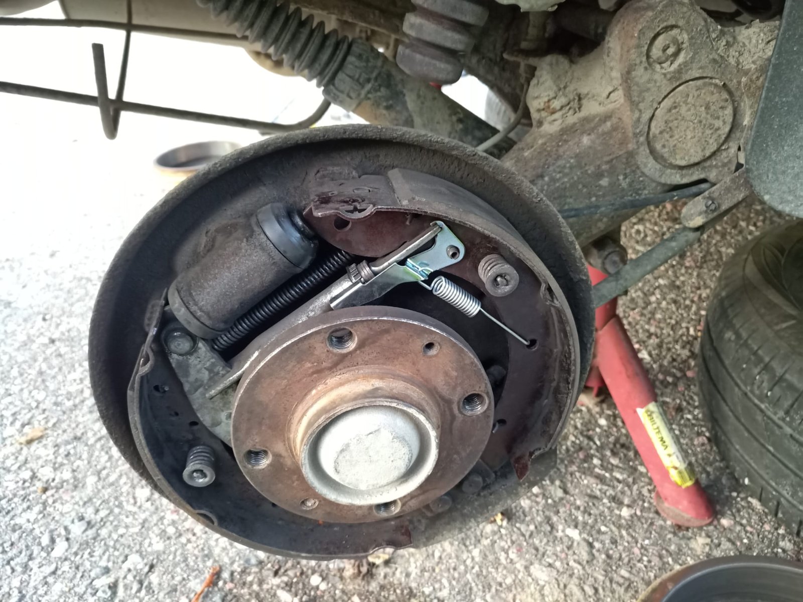

Sure thing, both sides shown here with brand new adjusters. Think I got three days til I heard the ominous churn again when the clips got pinned between the drum and the shoe, usually happens when I`m reversing, I hear this "sprang" sound then roll forward and hear the scrape and already know what happened yet again...

This clip and it`s tensioner spring don`t know what to call it but no matter what I do or which way I fit the spring they keep popping off.

as you can see from the picture the part that is supposed to turn the star gear is barely making contact with it almost like the clip part is too long and once once I pull the handbrake the clip overshoots the star gear thus getting loose that is the only explanation I can come up with

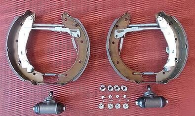

- Posts: 20539
- x 7921
Re: Hi from Finland!
I think you may have inadvertantly swapped the springs between wheels. They are handed and as you can see in the attached the springs lever end should point inward and the longer end goes behind the shoe. If you just move the spring in your pic behind you would have the top pointing the wrong way so I think you need to swap the springs over, side to side and fit as in this picture:
