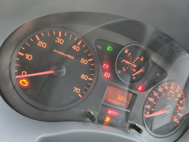

Hi,
I've got a 1.6 HDI dispatch, roughly 2010 in year. Here's some of the general 'might need to know' bits:
  • Battery is a bit weak, at 12.3v ish. Has started, unlocked etc fine but is almost always in eco mode
  • Everything generally works - no other issues I know of
  • No water ingress triggers
  • My lexia chose a good time to start playing up, but generic OBD2 reader showed no P codes
So I had the van running on the drive to test out a dashcam. It has a rear camera which I'd wired up to an accessory 12v, but - when testing it - I found that it was supposed to be wired to the reverse light and was on constantly. So I removed the wire I'd attached - nothing suspect about this part of it - and also tidied up the job. The dash cam has been wired up for a while with no issues, and this was just testing out the rear camera part. When I'd started the van, it did struggle a little bit to start up, so the battery was a bit weak at that point.
Went to start it up after I'd turned it off and removed the 12v feed to the rear camera, and turning the key had it beeping through all the possible faults (brake failure, airbag failure etc), and the dipped beam symbol is lit up - but the dipped lights won't actually come on. Tail lights seem to come on with ignition and won't go off, and it doesn't crank - you can hear a relay click but that's it. Dash looks like this:
I have tried all the usual candidates - I'm 99.9% sure that the jobby I was doing was unrelated, and I didn't do anything stupid/accidental in the 12v wiring - it seems just coincidental. I did try some brief BSI resets, but achieved nothing. Disconnected the rear lights and door looms just in case there was a short.
I've ordered a new battery just in case it's anything weird like that, but I'm stumped otherwise.
Is this a weird "having a tantrum" PSA thing that will - hopefully - either resolve itself overnight, or with the battery disconnected for a while - or even with a new battery?

Re: Electrical weirdness - what happened advice!
You should only wire accessories like a dash cam directly to a power source and never by splicing or taking a feed off other wires as these vehicles have CAN data networks and wiring-in non compliant devices can cause electrical problems.
I suggest you use a piggy back fuse to either a permanent live or switched ignition live in the passenger compartment fuse box.

Unread post by _cjj »
GiveMeABreak wrote: 04 Oct 2023, 22:15 You should only wire accessories like a dash cam directly to a power source and never by splicing or taking a feed off other wires as these vehicles have CAN data networks and wiring-in non compliant devices can cause electrical problems.
The dash cam is wired that way - the one I spliced off was for an unused switched live (for the towbar plugs that are not doing anything) that was only going to a little camera. It worked fine and started with it that way, and has since been removed, but doesn't appear to be related

ozvtr wrote: 05 Oct 2023, 11:38 Replace the battery, particularly if you are suspicious of it.
Fitted a brand new one today - no difference :?
Managed to get lexia working today - nothing particularly obvious came up. Ones in bold stayed after a clear.
BSI:
F406 (Oil Pressure sensor)
F40A (Oil gauge)
9528 (Absence of command of the starter)
F5FF (Unexpected re-initialisation fault coming from the BSI)
F9B8 (Power Latch relay fault)
Injection:
P0104 (Flowmeter signal)
P0691 (Fan high speed control)
BTC:
ABS/traction control:
communication error
Airbags:
9651 (supply voltage ignition switched +)
Radio
C917 & C918 (Front R&L audio output fault)
I wasn't actually sure if the ABS one was a smoking gun, or if it just doesn't have a module for that on the van
