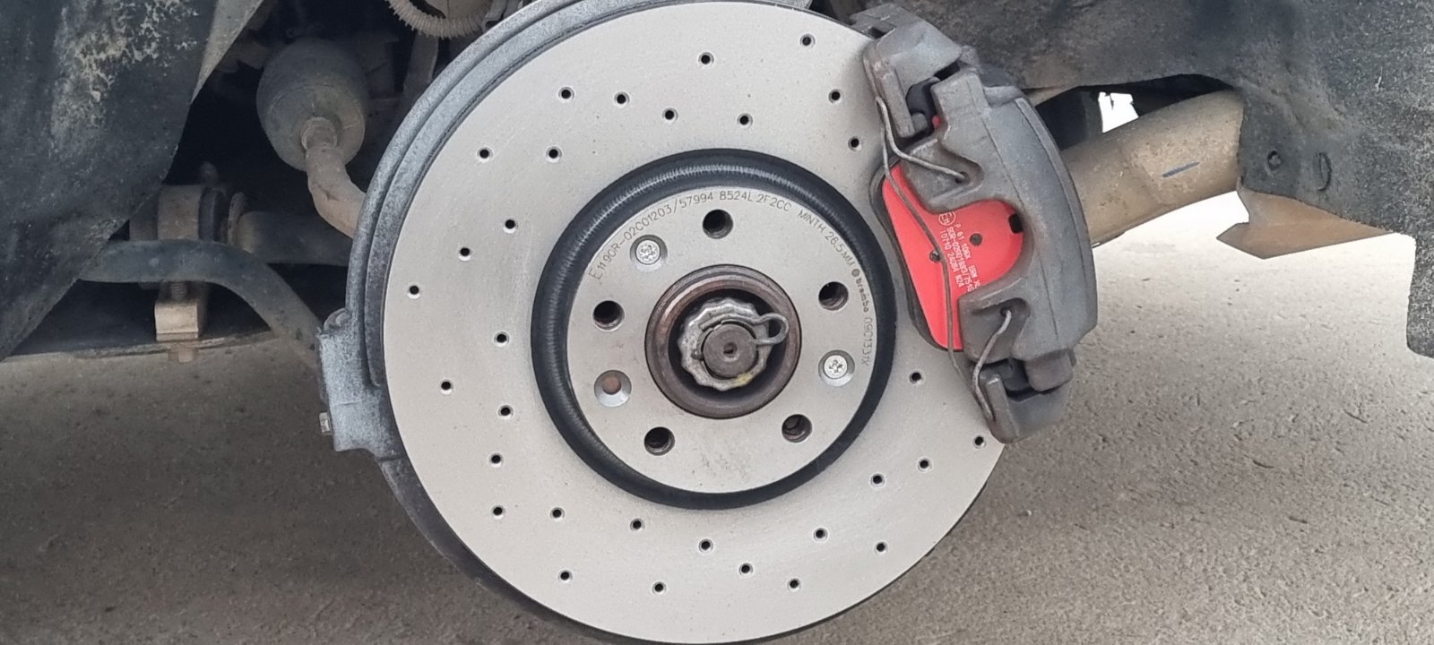

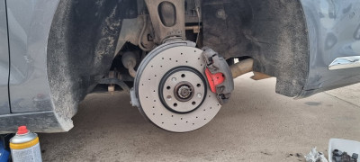

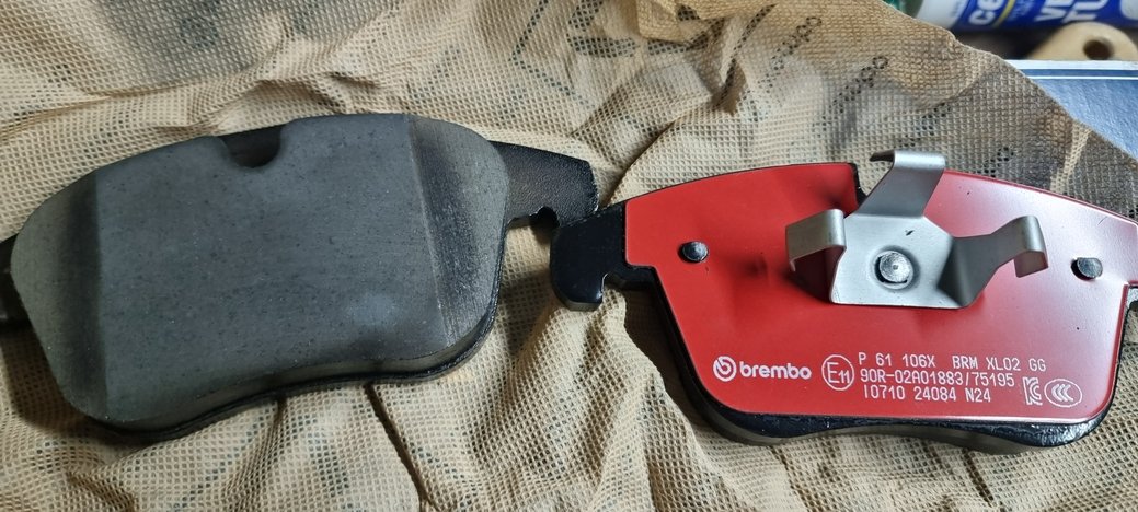

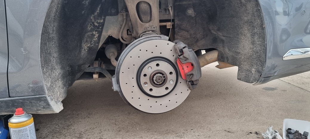

An upgrade on the C5: Got some extra stopping power with this new front Brakes, Brembo Xtra.
Braking fluid was changed for ATE TYP200
Also have some more material to install soon.

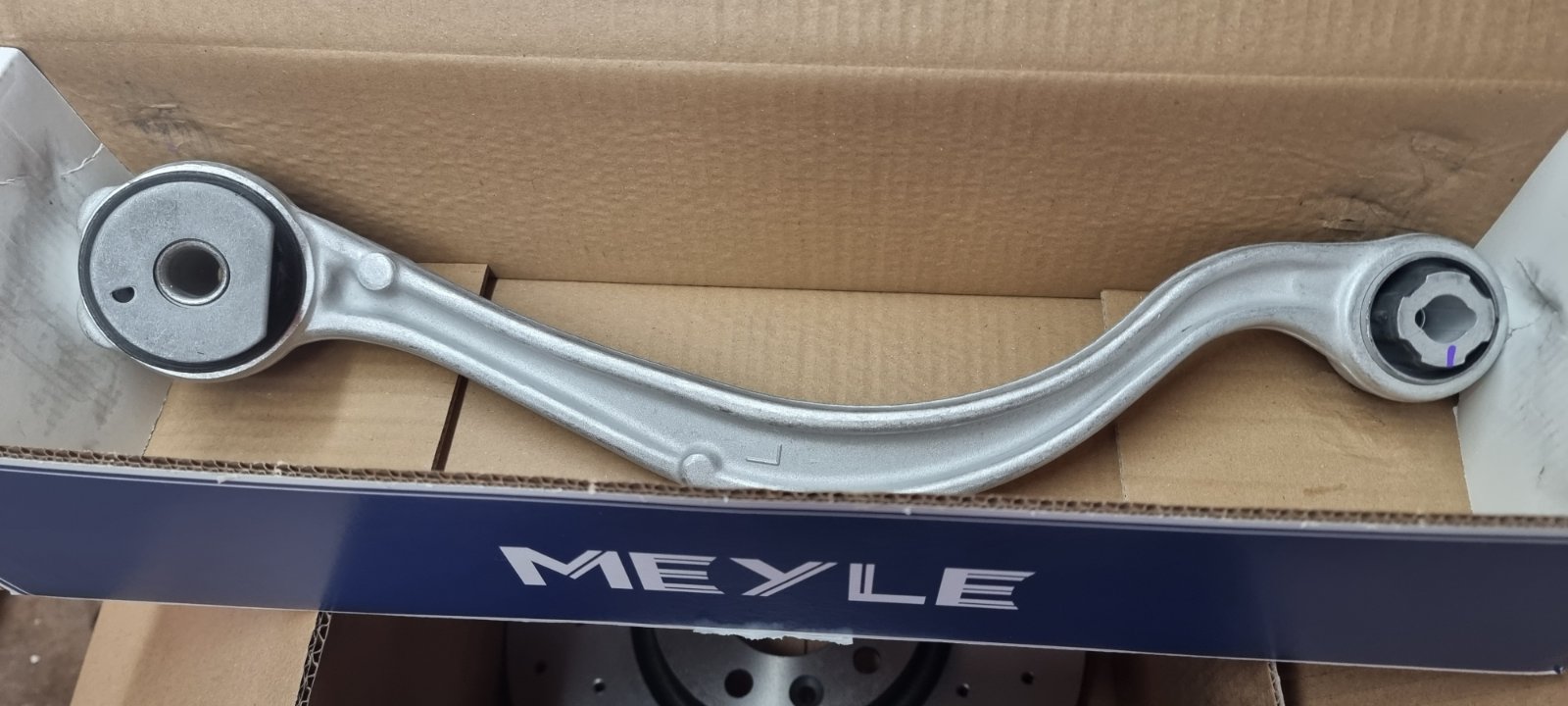

A good tip i can share with you is when going for aftermarket parts, Meyle HD seems to be the ones to choose, as they are reinforced. Unfortunately not all parts are available as HD. :roll:
Bit by bit is getting perfected :-D
