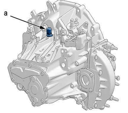

Is there a drawing or picture of the filler plug?

Re: X7 6-spd manual gearbox oil capacity
Paul,
If you look at my thread viewtopic.php?t=76132
I'm sure there is a diagram. Direct access is block by the sub frame.
Kenny
Kenny

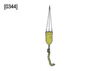

Filled using a gravity filler cylinder like this which may require the air filter housing to be removed first.
Thanks Marc. It was for the benefit of Armidillo that I asked.
- x 6955
No problem, a completely different gearbox to the 5-speed unit.
If it's anything like my 6 speed 2.2 then definitely need air filter housing out the way. Think pretty busy down there all the same.
I used a funnel pushed into a length of garden hose, not dislike the official tool. A way of hanging it up as they've got it would be a good upgrade (note: funnel full of oil much heavier than when empty and makes heck of a mess if you forget this!)
