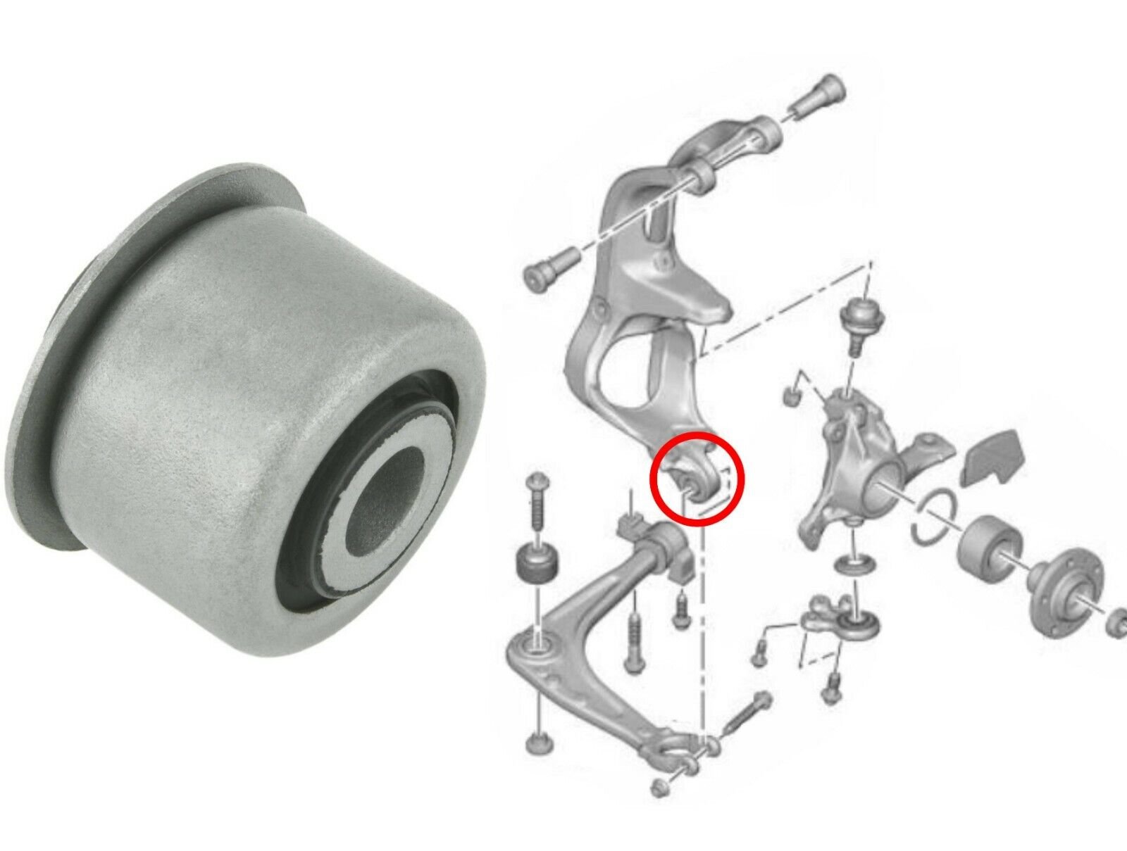

Good afternoon, I hope everyone is well!
Could I please have the correct part number for this bush here on my Citroen C5:
There seem to be lots of versions online, and I was not sure which was right for my particular model...

Unless I'm missing something i cant see it listed as a separate part from Citroen?c16rkc wrote: 02 Oct 2023, 14:05 Good afternoon, I hope everyone is well!

Ahuh... that might be the case... I never thought of that.
I bet they want you to buy the whole pivot arm...

Thanks for looking Wheeler.... in that case I'll venture what Febi Belstein say is the right part...

There seem to be plenty of suppliers of this bush on Ebay. Not OE of course.

It is not sold separately, but available commonly from online suppliers.
My local sourced a 'reinforced' one for under a £10 from their regular parts supplier (John Morgan IIRC).

Yes I only paid £10 inc VAT... so I bought three
just in case I break one.
Weird how Citroen think such as easy to replace part is not servicable...

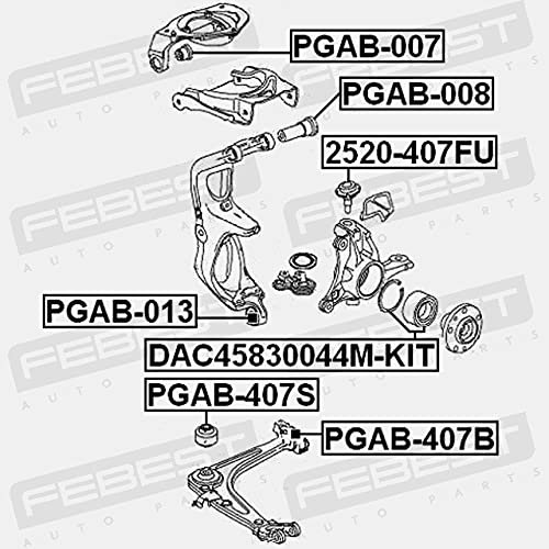

I actually replaced both in my car just last month,
it is a major component in terms of the car feel, mine were completely gone, so after the replacement, the car felt very good..
You can find alternative codes from different manufacturers here:
https://alvadi.ee/en/kataloog/varuosa/1 ... ct-tab-oem
FEBEST has a nice breakdown of thier offerings on control arm and suspension parts: Note: when visually inspecting the area on the car, it seems like it is not the correct part;
the new part seems very small to the eye, in comparison to it's position on the car, but that is just because of the housing around the part, rest assured it is correct.
in order to exctact the old part, you can get some specilized tool, or just do what my mechanic did.. brute force the old part of of there..
