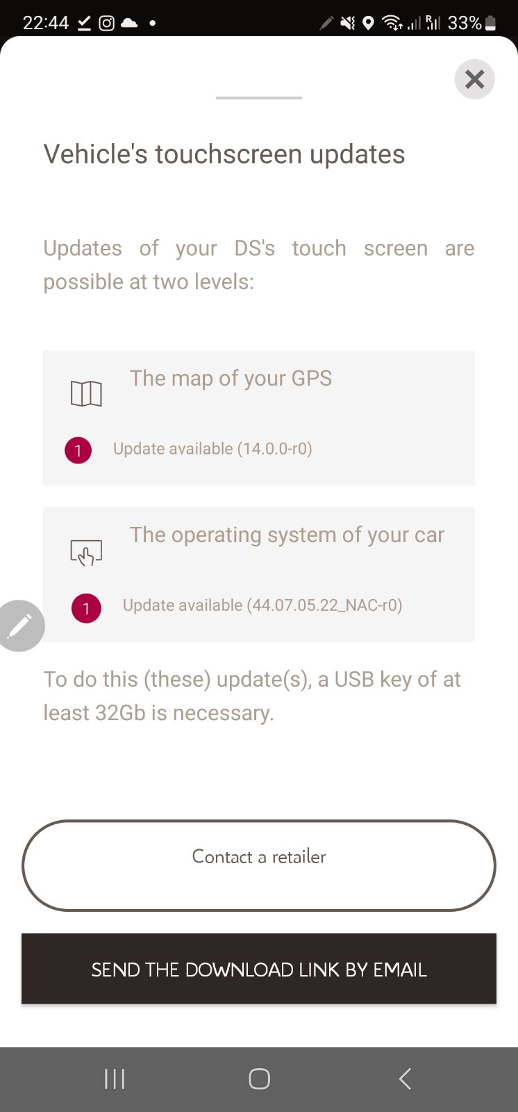

Hello everyone
I just got used DS 7 2019 I download the myds and it says operation system update is available but I don't know where to download, I went into website I couldn't find any application to download I saw some random images on Google about DS Update software , where can I find that also it worth to update the system or it will give me faults?

Thank you :) I couldn't see that from the phone .
But it really okay to update my touch screen or will it bring me a lot of trouble , I just got it I don't want to mess

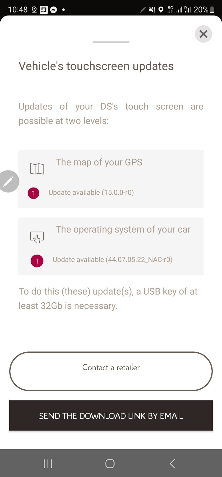

Hello I just connected the car with app and now it's still saying for update .... even after I updated with USB or is new? How do I check the version of my firmware ?

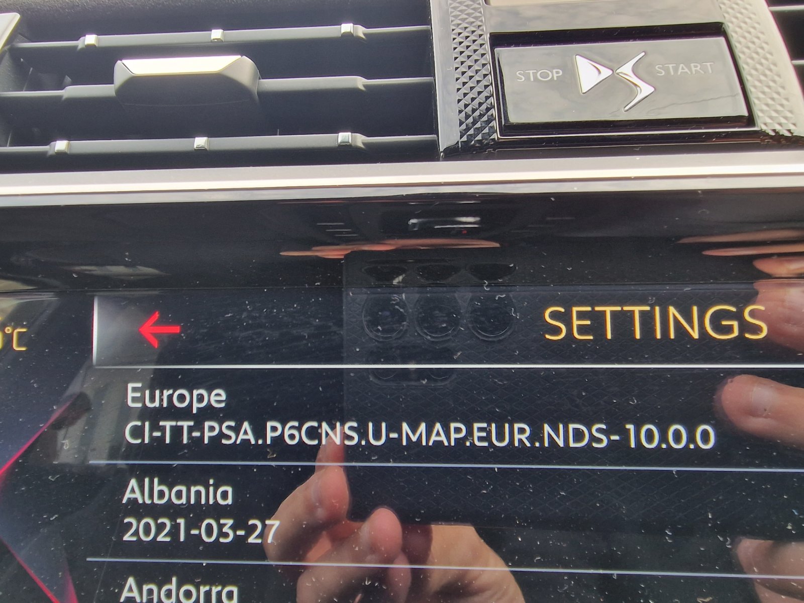

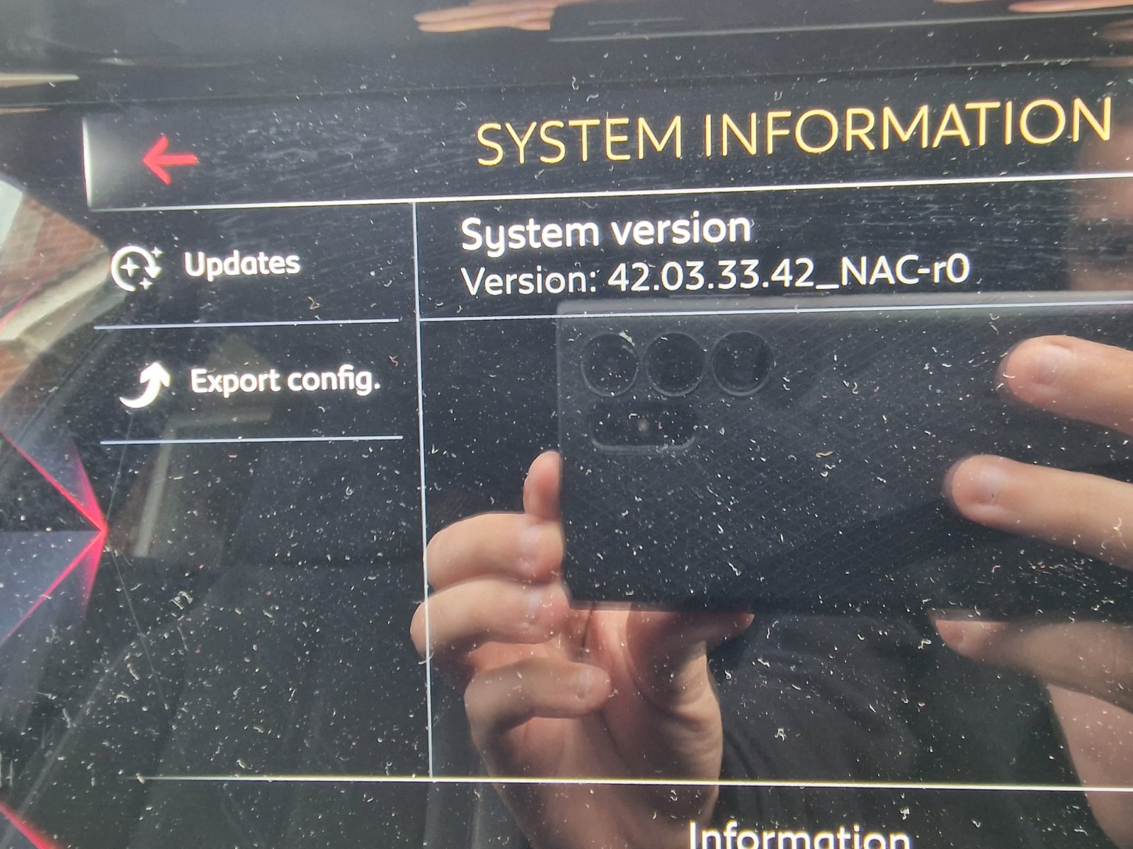

Hello I check it the version and it still showing my previouversion after the USB update , I did something wrong or my car doesn't want the updates?

Hello please check the attached images i took the app and my car
x 6945
Re: DS 7 Updater
Ok, so you haven't made any updates at all and since you last checked, there has been another map update.
So it never updated in the first place.
1) How are you updating the map? Are you using the DS7 App which downloads the update, formats the SUB and prepares the files on the USB?
2) When you have done the above, keep the engine running (so it does not go into economy mode and interrupt the update which can damage the system.
When you first insert the USB, the system will first give an error saying it can't find any media, just ignore or cancel that message, then it will detect the update and ask if you want to install it.
Let me know what happens when it detects the update and after you have said yes to update.
