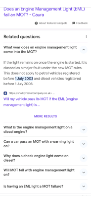

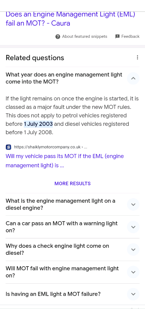

MOTs are a minefield and mine is due shortly. So a couple of questions, is that correct? Also is that correct? If so what age of vehicle? 05 or 06, would that include a 56 plate?
Aspire_helen said... (in a different section/topic)

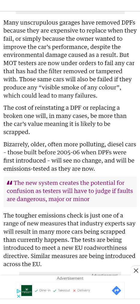

thought I would remind myself of the MOT rule regarding DPF and visible smoke.
8.2.2.1. Exhaust emission control equipment
Defect
(d) Exhaust on a vehicle fitted with a diesel particulate filter emits visible smoke of any colour
Category
Major . Sorry not very good at this quoting stuff. Would that include the 05-06 as above?

So what about 05-06 with dpf fitted? Would that be a fail if showing smoke or are they exempt from that rule? If I'm asking then I bet there's loads out there thinking of asking.
