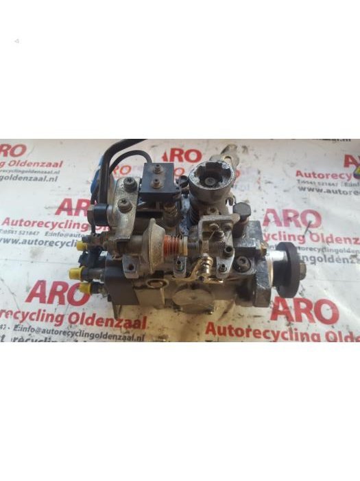

Re: Berlingo 2001 1.9D Bosch mech fuel pump microswitch
I found a Bosch pump with nearly 200,000 miles on it, with the switch on top for 99 euros, in Holland !
I have a pic of it......
My switch has lost the mount and roller arm.
That's the rear view, you can see the switch and black cam follower on the top.
You'll likely not notice any difference with the microswitch not working... As far as I recall, all it does is detect when the engine is well off idle and turns off cold advance and glolwplug post-heating when the engine coolant is still below 60 degrees C.
This is done on the basis that despite a cold engine, it's driving along under load so the post heating and cold advance is no longer needed.
Unless you live in penguin-land and it regularly falls cold enough to make brass monkeys shiver, I'd not be over worried about it...
