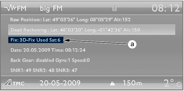

To see number of satellites detected:
Reset the audio-navigation to zero again then drive for 3 mile drive to highlight a failure at the aerial base or aerial cable end. If the vehicle position is still incorrect after the test then it will be hardware failure and repair is to replace the Head Unit.
Of course if it improves or resolves the issue then it'll be the cable connections or the aerial base.
- Press and hold the button "SETUP"
- Select GPS coverage
