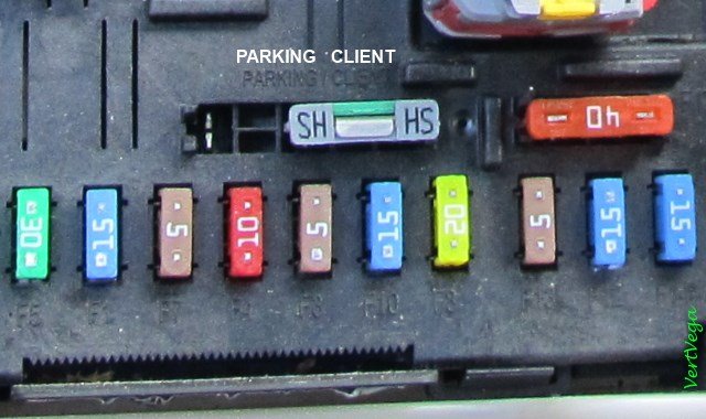

Hi, has an aftermarket radio been fitted?
Has anyone been messing around in the fusebox?
Check the shunt in the fusebox is in the client position.
If thats ok check all the fuses.
