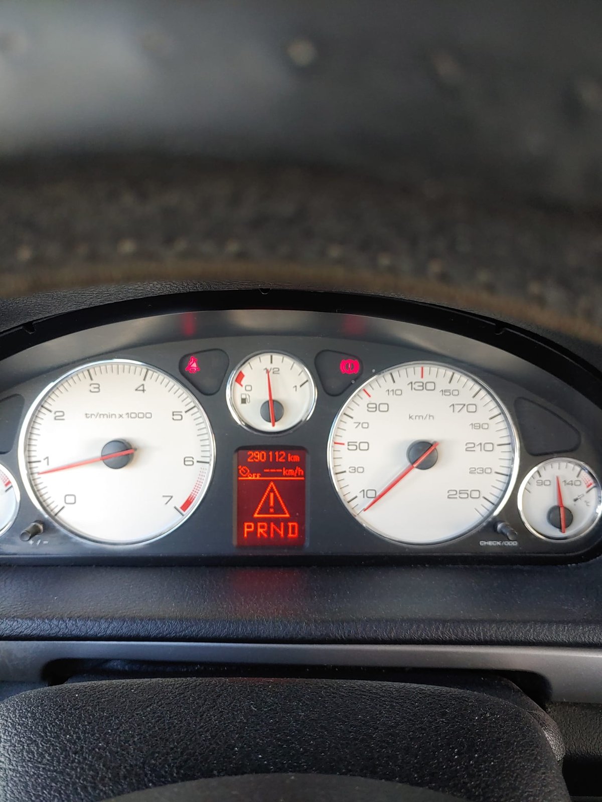

i replaced my battery to new one and after couple of hours i am getting error on my dashboard saying PRND
i attaching a photo for this

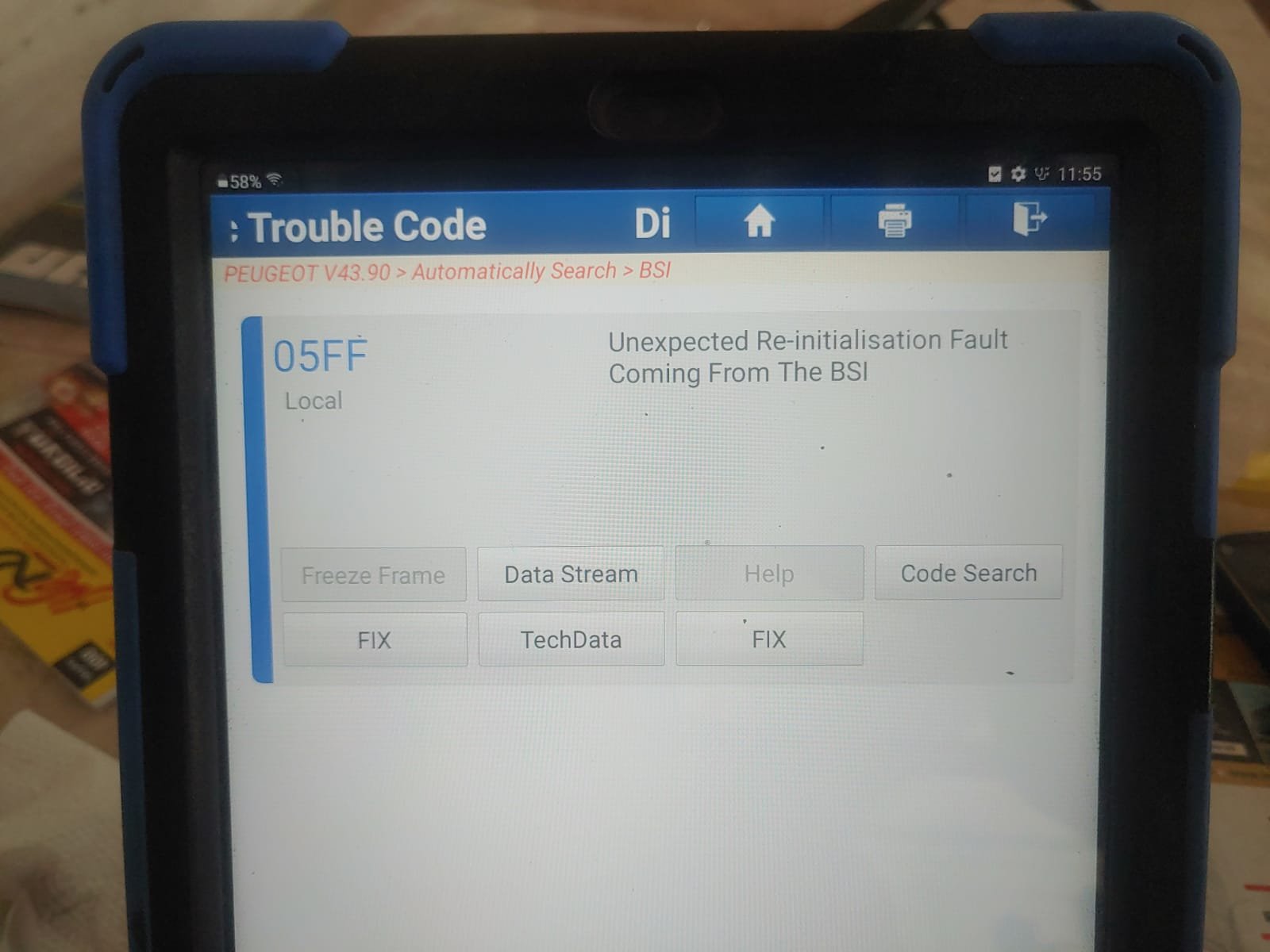

i did a scan and i am attaching the result of it
also i must to say that all works good! and gearbox work 100% like it worked in the past
please help me with this problem

Re: Peugeot 407 Issue
Follow this procedure for changing the battery:
BSI Reset / Battery Disconnect / Reconnect Procedure
The PRND warning is a general warning concerning the automatic gearbox. In order to ascertain the issue it needs a proper diagnostic with PP2000 / Diagbox. I wouldn't recommend driving it until you know what the problem is, otherwise it could exacerbate any faults already there. You don't want to get stuck if it completely fails. So my advice is to get it to your dealer or a competent mechanic with a decent diagnostic tool to ascertain the fault codes, then if you put the codes up here along with your VIN we can help explain what they mean.

Hello, So I went to an official Peugeot garage
They did a BSI reset for me and it didn't help anything
They did a computer scan on the al4 gearbox and no fault has been founded
But still the warning of PRND fault appears
They suspect that the problem is with multi function
What do you suggest?
