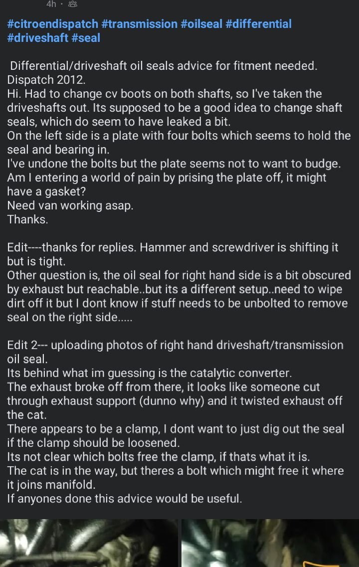

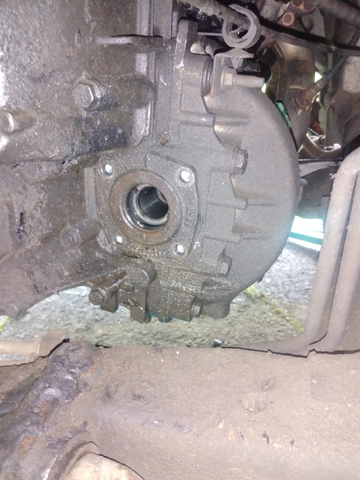

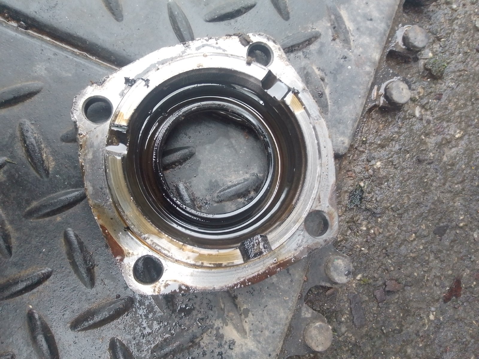

Hi. Thanks for advice. I got shafts out. Split boot trying to get it on with cone, local garage put boots on for me and now doing other shaft, which I removed.

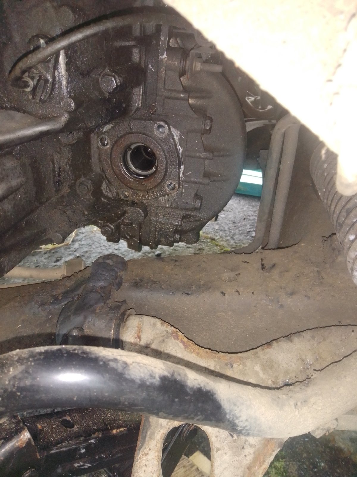

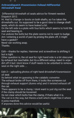

Its recommended to change diff seals..one parts place said they pop out with screwdriver but the left side one was a plate held on with four bolts that seems to hold the seal and inner bearing in, with what looks like a gasket.

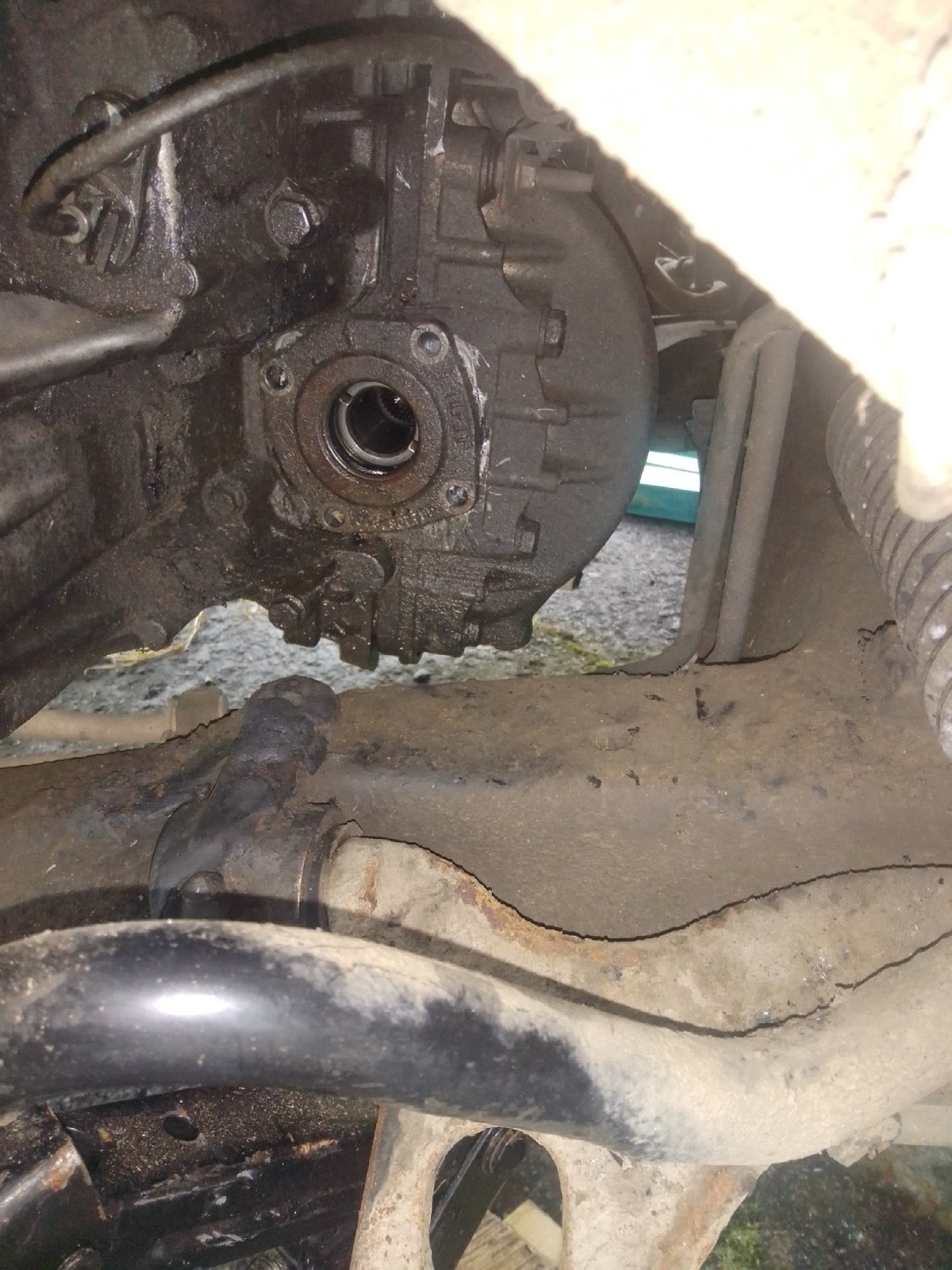

The right side seal is behind the exhaust, kind of accessible ..but...not sure what to unbolt to change right hand seal. Maybe I shouldnt change seals..need the van running.....?
Edit- plate on left side seems glued on with sealant. Trying to lever it off.
Its hold in by more than bolts. Rotates but stuck.
Edit-- its off.

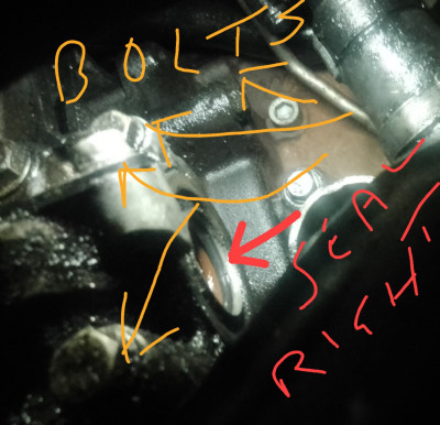

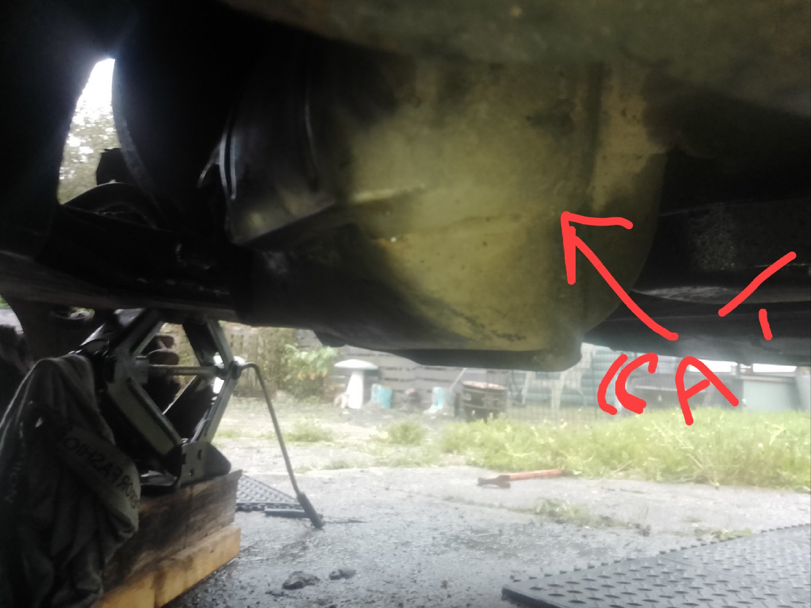

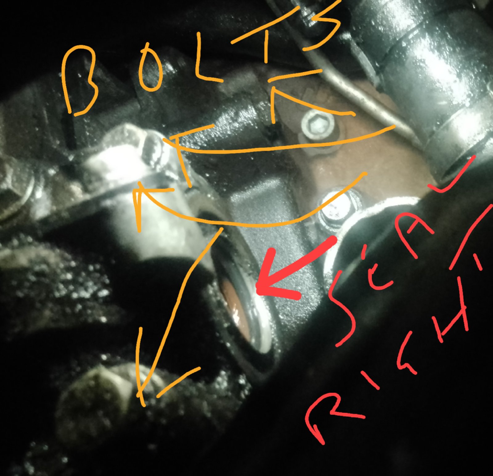

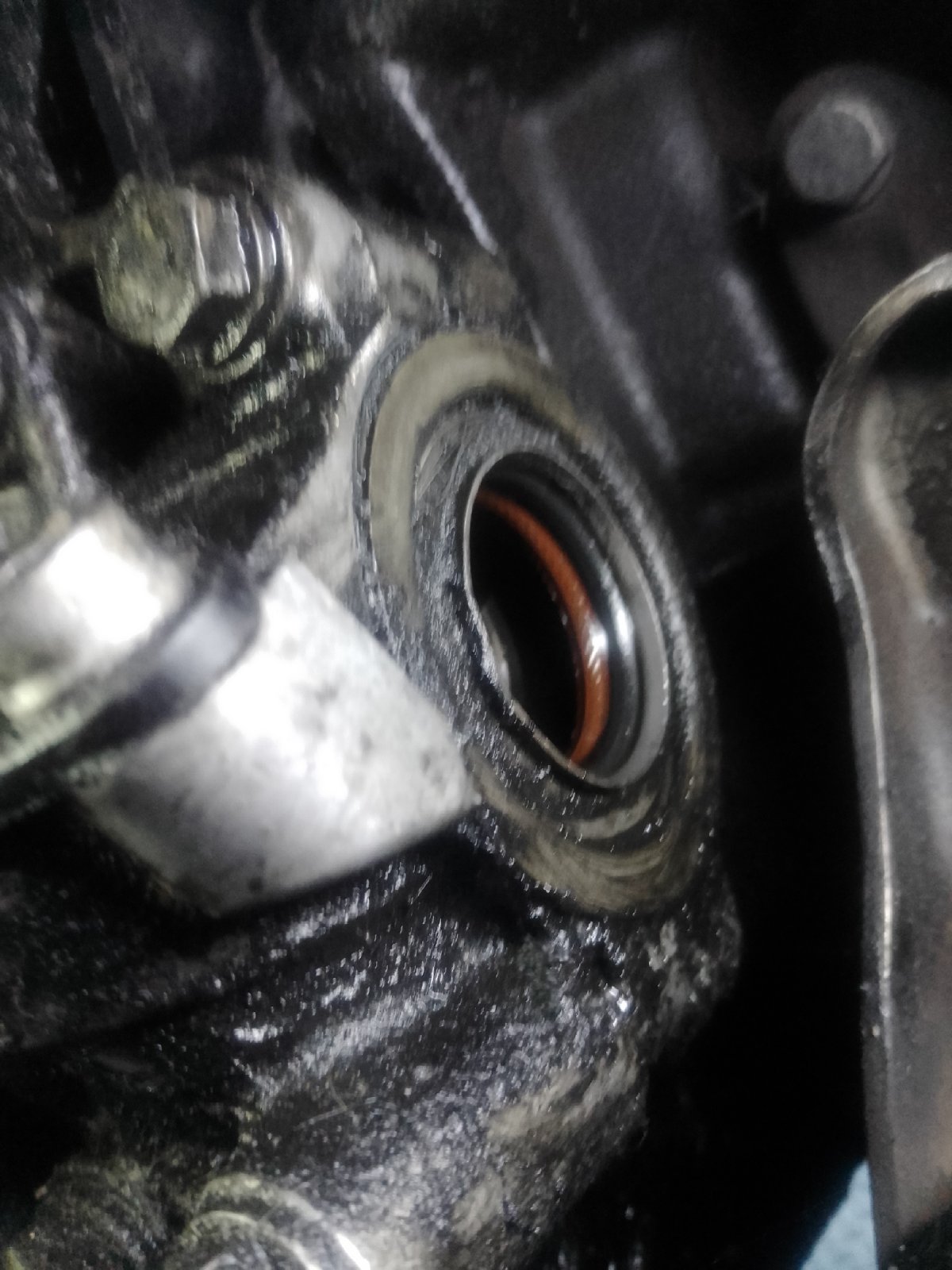

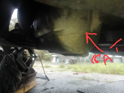

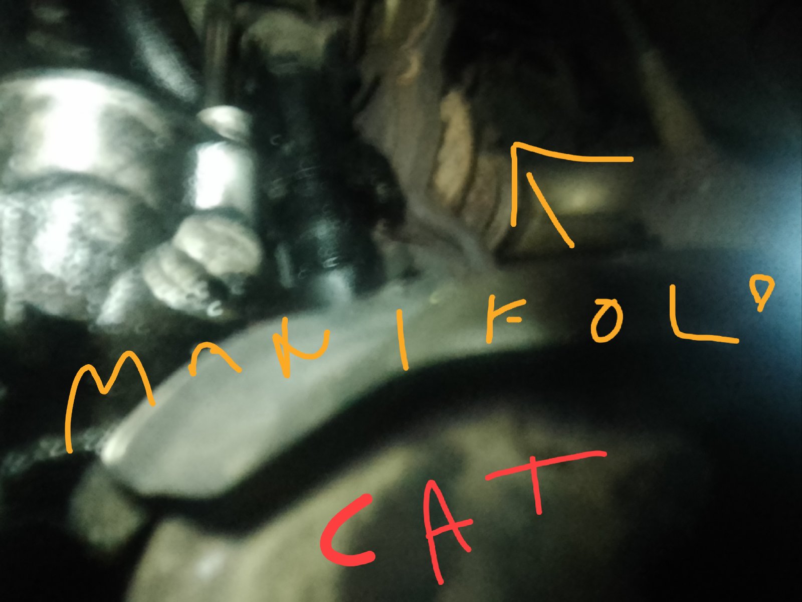

Uploading photos of right side seal. There seems to be a housing but which bolts to undo is not clear.
Some of the photos are for the left side seal.
Thanks in advance.
Edit-- its off.
Thanks in advance.

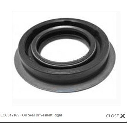

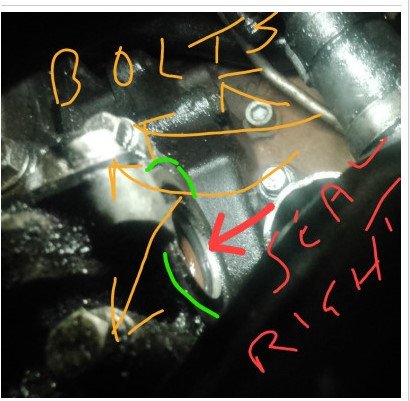

Think this is the seal:
Appears to have a metal backing ring, so should just lever out, where I've marked in green:

Many thanks for reply. MPD have supplied me a febi bilstein seal 027816224488 for the right shaft. Still in packet, it doesn't have a metal flange..so I'll clean up around where the old seal is fitted and see if it looks like it will prise out.RichardW wrote: 03 Oct 2023, 12:44 Think this is the seal:
Edit- you were right. I prised old seal out, ut has metal flange. Most supppliers show seal withoui flange, MPD got the same wrong part in twice.

Bit of a nightmare. The seal you picture looks like the one on my vehicle. MPD have supplied one without a metal flange which is listed for some citroens: febi 22448 also citroen ref 3121.46RichardW wrote: 03 Oct 2023, 12:44 Think this is the seal:
I'll look up the part in your pic using the cat number visible.
Not sure what would hold this seal in place apart from friction. Maybe drive shaft keeps it in place.

Just held in by friction, just lever it out under the metal edge, then tap the new one in with a socket or block of wood. I just searched for Dispatch driveshaft seal, and found this one: https://www.eurocarcare.net/gearbox-par ... right.html

RichardW wrote: 05 Oct 2023, 07:42 Just held in by friction, just lever it out under the metal edge, then tap the new one in with a socket or block of wood. I just searched for Dispatch driveshaft seal, and found this one: https://www.eurocarcare.net/gearbox-par ... right.html
The saga endeth: RichardW was correct. I thought I'd get the part quicker locally but MPD got the wrong seal twice and said I had the wrong gearbox...
Even a Citroen dealer drew a blank with the new part number until i sent pictures...
For the record, citroen part number is 1675689680 which has been superceded by 1686556580 which most places don't recognise.
Right side gearbox lipseal.
Edit: the saga never endeth. Citroen sent me a flangeless seal with a wobbly exterior rubber lip which probably wont like being tapped in with a socket. Nothing to stop it going into diff, not that I'd do such a thing...

Hi I have the same drive seal ns cap with 4 bolts and struggling to remove it.
Could you give me some advice how to get the seal cap off please.
kantica
- Posts: 39
- Joined: 01 Jan 2020, 21:24
- x 10
Re: How to remove nearside driveshaft Citroen Dispatch 2012/change transmission seals
Stick slightly larger screw (or something similar) into diagonally opposite holes of the bracket and pull it out.MARKPARRY1971 wrote: 06 May 2024, 17:55 Hi I have the same drive seal ns cap with 4 bolts and struggling to remove it.
