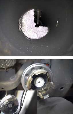

I would be thoroughly checking where the injector is housed - inside the port to make sure that is not full of crystallised Urea. See below - sometimes the blockage is past the injector and in the Cat.
Whew you do get it resolved - I strongly suggest you start using some Wynn's / Forte Adblue Additive to help clear and prevent crystallisation in future.
