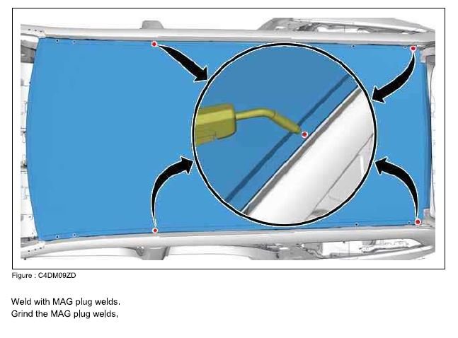

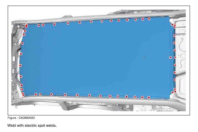

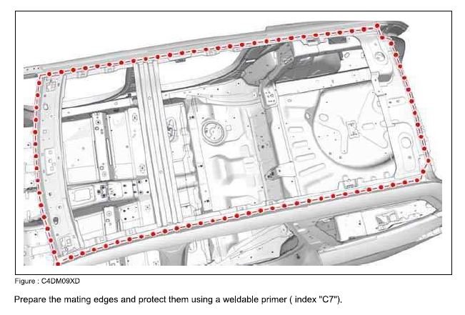

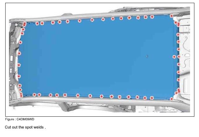

The process for replacing the roof panel does feature in the workshop manual, but not sure you'd actually be able to buy a new roof panel.
There's various steps to replacing it - here's a few for info, though as you can imagine, there's an awful lot more to this process than I've illustrated here.
