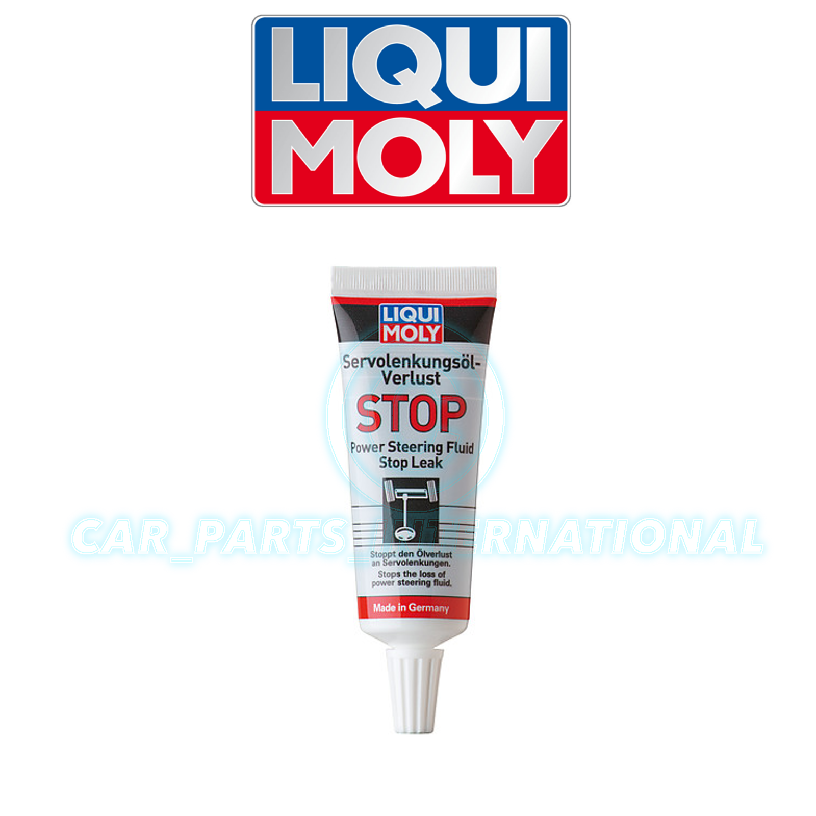

Anyway since then the level hasn't dropped one bit without doing anything to it, however I bought Liqui Moly 35ml for £10 added it to reservoir anyway as it apparently reconditions the seals and does other gorgeous stuff.
Anyhow it stopped leaking after around 400ml of genuine LDS hydraulic oil was added to it through several top ups and hopefully the Liqui Moly additive will help also.
It was definitely the wrong fluid in the rack when I bought it and now the power steering feels excellent with the correct LDS hydraulic oil in it. Hopefully the leaks at the seals are fixed also, it was not leaking at the steering column.

Glad to hear it worked for you
The steering column leak failure mode seems to be:
Pinion shaft corrosion = rough shaft
Rough shaft = ruined lip seal
Lip seal ruined = leaks LDS
So I'm not sure the liquid moly could defeat that, but might delay the inevitable with a bit of luck!
Perhaps caution for those with hydropneumatic suspension as obviously the liquid moly will be fed round that circuit due to the shared reservoir.

I've no idea on the corrosion level on the pinion shaft, I'll be changing the oil after 2 years in a few months, cannyou see it from underneath with the engine floor protector removed?
Is the lip seal you state the green ring where the steering column goes into the shaft? (I have been looking at photos from the topics) My mechanic said it was leaking from both sides near the CV boots?
BTW it stopped leaking before I added the Liqui Moly after a few top ups with LDS.
I don't think Liqui Moly would do the pneumatic suspension versions any harm, from what I read it should even help any problems in there also. It is only 35ml per tube.

The green ring has been deduced as Citroen's in-depth and thoroughly comprehensive solution to the corrosion issue (not present on early racks, only obvious difference on the "modified" version)
From feedback seems to suggest throwing a thimble of water at a burning building would compare in effectiveness...
Near the CV joints is an odd description and not that helpful= near the outer CV joints would be the track rod ends (well beyond the hydraulics of the rack!)
Near the inner CV joints = one is close to the left hand rack boot, the other close to centre of the car (not aware of anything in middle of the rack itself that could leak!?!) So descriptions aren't really pinning it down for me, sorry!
Agree it's a tiny volume (35ml) in a big tank of LDS but just to flag up it's going other places in a hydropneumatic car.
