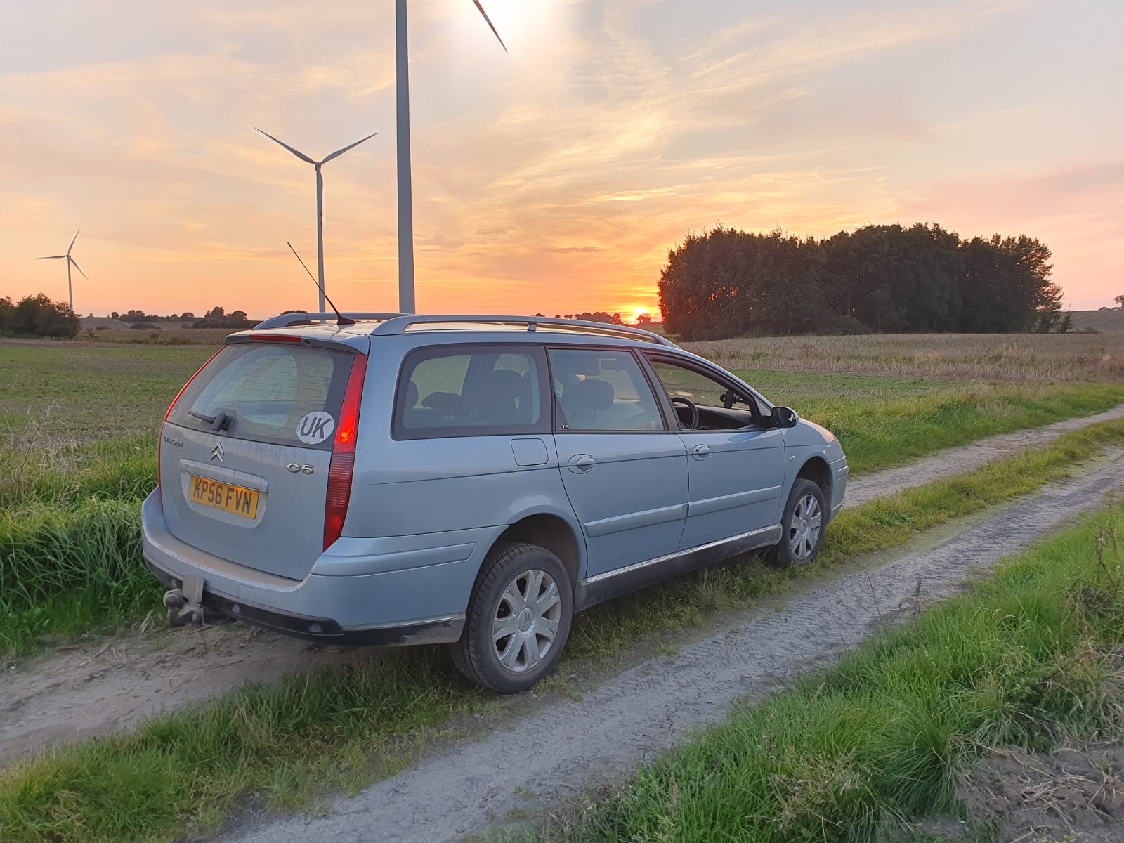

Hi everyone, currently on holiday in my trusty 2006 C5 with the 2.2 HDi engine. Before going away I'd had a couple of issues with a randomly appearing ESP/ASR fault which had absolutely no pattern to it at all. It seemed to settle so I left it. It has also always smoked quite a bit under hard acceleration (black). While in Germany on our way to Poland, after the fourth time of the light coming on and severely restricting the car's capabilities of accelerating, I decided to try and unplug the MAF sensor to see if it would keep the warning at bay as I had a feeling it would have something to do with that.
As expected I had an engine management light but I knew what it was regarding so I wasn't fussed. Unplugging the sensor kept the ESP warning at bay at the expense of being unable to use cruise control, but at least I had full acceleration back. While in Poland I've ordered a new MAF sensor as parts are generally far cheaper here, and I've fitted a replacement genuine Continental one for around £80. The warning has since stayed at bay and the EML has extinguished so I'm assuming that was the faulty part.
Now though, it seems as though it is smoking even more than before under acceleration, particularly if you're in a high gear on a motorway going uphill for example. There is a noticeable flat spot in acceleration where the smoke appears worst. I'm not sure if it is because the car is absolutely wedged with luggage and I've just not noticed it when working it hard before or if something more serious is developing.
No other unusual signs of a problem. Serviced it a couple of weeks ago and it has done around 2000 miles since, oil was the correct recommended type of Total Quartz. It doesn't appear to be burning oil or anything like that. No other warning lights or messages. Obviously no access to Lexia just at the moment.
Unrelated information of note however is this car is unbelievably excellent at everything, particularly navigating poor and often unpaved road surfaces in Eastern Europe and the cobbled potholed country lanes are ironed out perfectly by Hydractive. I want to keep her going!
Many thanks in advance for your suggestions.
