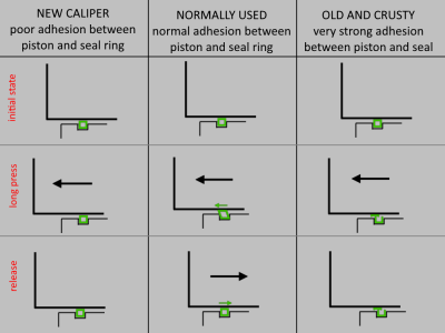

I have a working theory on what might be going on, and not a solution, but a workaround. (UPDATE: This is all wrong, it was the handbrake mechanism after all.)
After 4 days and 4 complete disassembles and reassembles of the calipers, and triple-checking everything else and making sure everything moves free, my conclusion is this (see attachment).
When the caliper is new or refurbished, like both calipers I had issues with, the piston slides smoothly over the piston seal ring. That's why these calipers are so easy to compress. However, that means the seal ring can't deform as much as regular before breaking adhesion with the piston, therefore the seal ring can't act as a return spring, like it normally does.
During the initial setting of the piston, when you pump the brakes, it has a relatively long path to travel to press firmly against the back of the pads. When that happens, it slides smoothly over the seal ring without deforming it. So when you release the pedal, the pressure is relieved, but there's nothing to return the piston. So it keeps pressing against the pads - very gently, since there's no pressure - but nonetheless it keeps pressing. With good pads and rotors, the friction is strong enough to cause excessive heat even with minimal pressure.
Once the caliper goes through a few hundred heat cycles in the first month or so of normal driving, the adhesion between the piston and seal ring is increased, so when the piston moves, it deforms the seal ring, and when the pressure is released, the ring pulls the piston back.
Once the caliper gets old and crusty, the seal ring gets glued to the piston, which causes it to tear if the piston moves too far. This is what happened to my original caliper which set me on the path of all this craziness
So, the workaround I found - when the caliper starts sticking - the piston has slid freely over the seal and the seal isn't acting as a spring to return it - I pull over, pull the parking brake hard, pump the brake pedal several times as hard as I can with the parking brake engaged, release the brake pedal, wait a few seconds, and release the parking brake.
And the caliper lets go.
