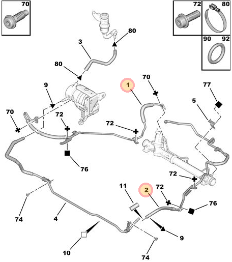

Unfortunately it's not that easy. Places like Autosteer are where I got my third rack from after the original failed and then also the second new Citroen rack at over £1800 was replaced under warranty by Citroen. So third time I opted (out of warranty) to get one from Autosteer back when these were just starting to go wrong and pipes were available.
The issue is the pinion gets water in the base where it enters the rack, it then gets underneath and rusts, starting to deform the seals and o rings. The rust then starts eating from the inside out and contaminates the other seals if left. The leak then gets progressively worse.
There are also 2 types of rack angle depending on your model and wheel size, so essential to get the right version. But as said, it's the power steering pipes that are no longer available that may be your issue as these are not designed to be removed and replaced - as the seal can deform when removed after the original tightening.
A whole thread on it here that I started, with many contributions from other C5 X7 owners, and some possible solutions.
viewtopic.php?t=60155&hilit=steering+rack+again
These are the pipes for my 2.0 HDi 138 model and both the High and low pressure steering pipes marked at (1) & (2) are not longer available from Citroen!
