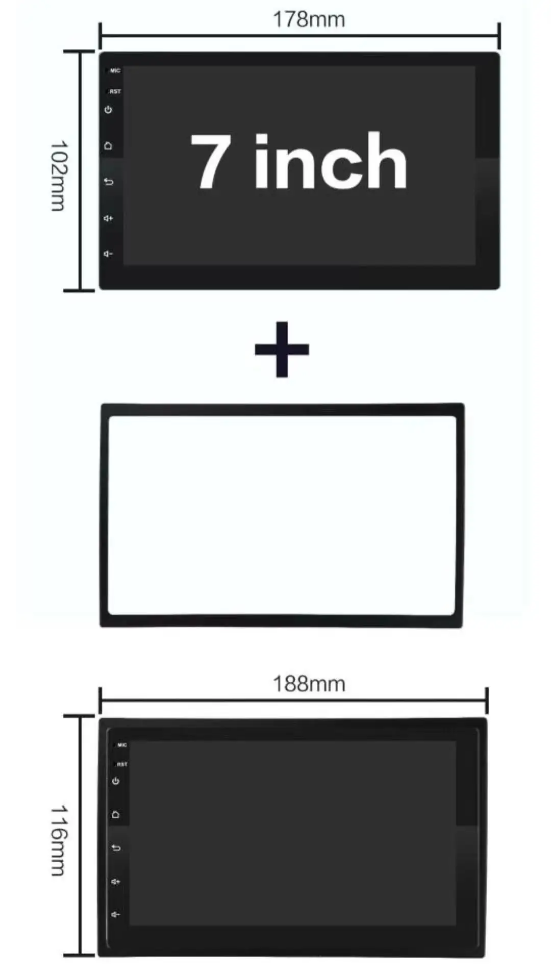

This got me thinking – instead of paying for the sensors to be re-enabled, why not purchase a Chinese Android unit and install it in my car along with a rear camera? The challenge is finding a good 7-inch multimedia unit that fits in the same space as the old screen. I found one on AliExpress here: https://www.aliexpress.com/item/1005004 ... 4itemAdapt
The seller sent me this image and mentioned that if the size matches, it should work:
So, my question is, has anyone ever installed an Android head unit like this in their Citroen C5, and does it fit properly in the space of the old 7-inch screen?

As for an Android replacement - not as far as I am aware they are too big to go into the space and are not designed to be bolted into the fascia like your existing screen, so no.
