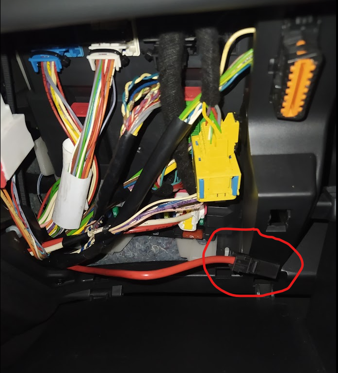

Quick question; whilst checking the fuses in the glove box compartment; I noticed there is a loose cable which isn't connected; is that meant to be like that?
Photo is attached and cable in question is highlighted.
Again thanks in advance,
Guillaume
