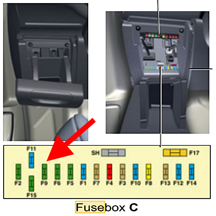

thanks Marc, yes you had the same problem, not turning off as expected
F4 it is.

GiveMeABreak wrote: 22 Jan 2018, 18:31 Ok, so Fuse F9 is the one arrowed in Red and is 30 Amp for the Cigarette lighter.
Remember that this is permanent live at the fuse box, but the cigarette lighter itself is switched off by the BSI on economy mode or after a certain amount of time. This was no good for my setup, as the dash cam obviously stayed on for quite some time after I left the car - and if you don't manually switch the dash cam off it will stay on and gradually drain the battery over time.
I used Fuse F4 just along to the right in the picture above. This one is for the "Automatic gearbox - additional heater unit (Diesel) - electrochromatic rear view mirrors" This one is switched positive.
