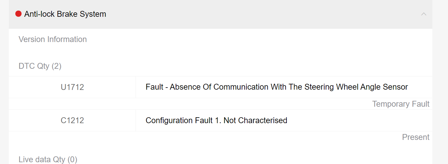

Hi have a citroen relay 2014 with this fault i used diagbox today to code "new" module but fault is still there i just plugged in abs pump im wondering does it need to be piped up for it to work and get fault off thanks vin number is VF7**************[VIN obfuscated, can be read by forum staff] Pump is vin matched its a ebay job so maybe its faulty any help greatly appreciated thanks

That suggests to me you need to calibrate the steering wheel angle sensor as it states. Just because you have the correct ESP / ABS module fitted (part wise), it doesn't mean it's plu and play. You should try and have the sensor calibrated using the correct diagnostic tool and see if that resolves your issue.
