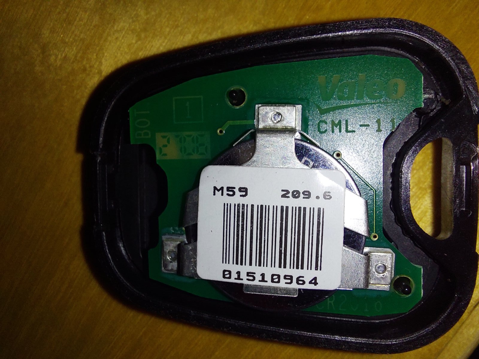

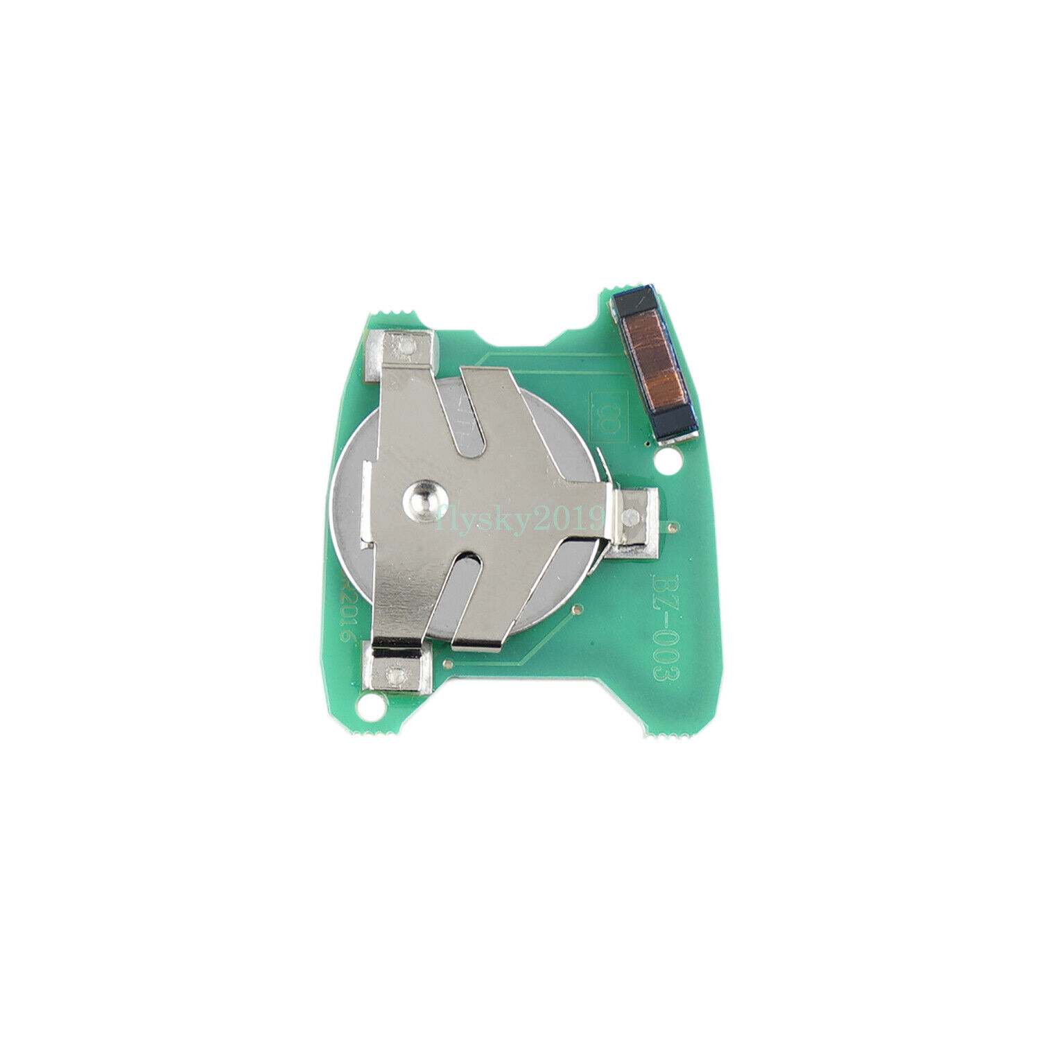

Michel
Re: Non starter.
Unread post by Michel »
Can you post a picture of the key fob please? If it's the same as my old Berlingo, there is a little chip in the fob that isn't part of the main board. You need to prise it out and put it in the new fob.

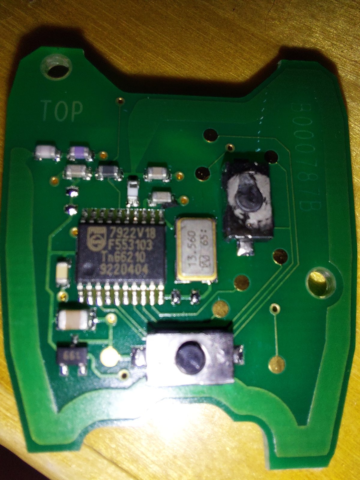

eMeSaR
Posts: 6
Joined: 08 Sep 2023, 21:32
x 1
Re: Non starter.
Unread post by eMeSaR »
Managed to send pictures of the key fob by android. 👍

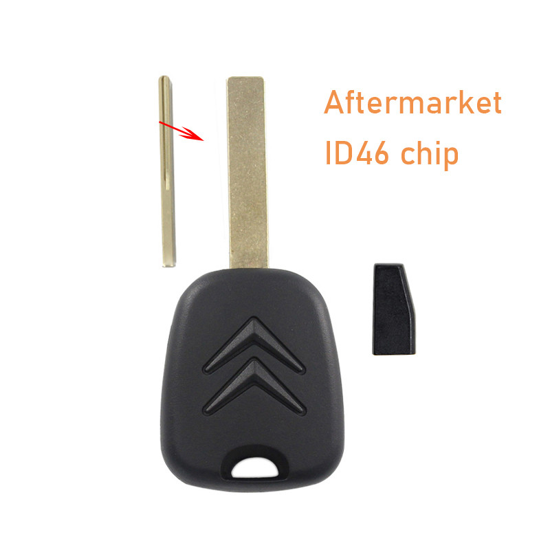

Re: Non starter.
Unread post by Paul-R »
I reckon it's missing the ID46 chip.
The chip might be a separate item and even smaller than the one in the first photo. Roughly 5mm by 2mm.

Re: Non starter.
Hi Paul.
Ya, the little chip was found in the casing for the key fob.
You wouldn't know it's there unless you know what to look for.
Got it all sorted now.
