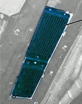

There is a heater/cooler as part of the oil filter housing which will heat/cool to coolant temp which is usually around the 90deg point under normal operating conditions. There's also a cooler under the floor in the return line before fuel drops back in the tank.

The fuel cooler cools the fuel as it returns to the tank.

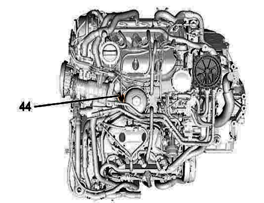

Sure:
Fuel Temperature Sensor Shown at (44).
Role of the diesel injection ECU as a function of the information received:
The more the temperature increases, the more its resistance value is reduced.
- To adjust the fuel flow
- To calculate the fuel density

Re: Normal fuel temperature on 2.7 HDI ?itroen C6
Thanks. Looking at where the sensor is located, it is normal for the temperature to be around 90 degrees. But there is also a fuel cooler underneath, as I looked at the diagram, the fuel is under the passenger seat. I need to check if it cools the fuel that goes back into the tank. One of these days I will look down at her and check.
Here:
