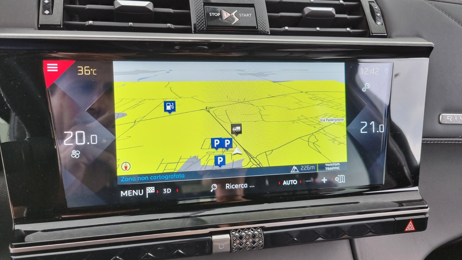

Hi guys,
yesterday I have updated the touchscreen of my DS7 Crossback (2019) according to the DS Update app, and the update consist of the new firmware 44.07.05.22
Everything was fine, till I opened the navigator app, and it always show the maps in yellow colour.....(see attached image) :conf:
I have already done the hard reset from the general settings, but nothing changes.
Anyone as tried this update? same issues?
thank you in advance

There's nothing wrong with it. The large yellow areas are there to show you the congestion charging zones! :-D So keep an eye out as these may or may not be areas that charge you to enter if you don't have a compliant vehicle. It's how the latest updates have chosen to notify you.

GiveMeABreak wrote: 04 Sep 2023, 21:53 There's nothing wrong with it. The large yellow areas are there to show you the congestion charging zones! :-D So keep an eye out as these may or may not be areas that charge you to enter if you don't have a compliant vehicle. It's how the latest updates have chosen to notify you.
really??! seems that every road is in a chargin zone! :lol:
please, do you know if it is possible deactivate this option? this "golden land" is too annoying while I drive :!:
thank you
x 6945
Re: DS 7 Touchscreen update issue
Not sure to be honest as thankfully the thieving so and so's haven't made it to our village yet, so I can't check, but have a look in the mapping options / POI selection and see if there is an option to disable it.
Yellow is basically a Low Emission Zone - and has been in place since the latest updates from July and so far as we know there isn't a way to disable it yet if the above doesn't work or there isn't an option shown to disable it.

Thank you for the explanation!
Unfortunally I can't diseable It... Will see in the next update 😉

I had a similar issue with my DS9. Had decent colours before the upgrade and then went to dayglo yellow afterwards. Makes the interior look tacky.
Tried to change it but the settings don't allow, all i could do is change the map display to night mode.....which I expected would make things better but it doesn't. The colour is a bit duller but worse. Gives the missus and kid something to laugh at me about while I moan about it.
