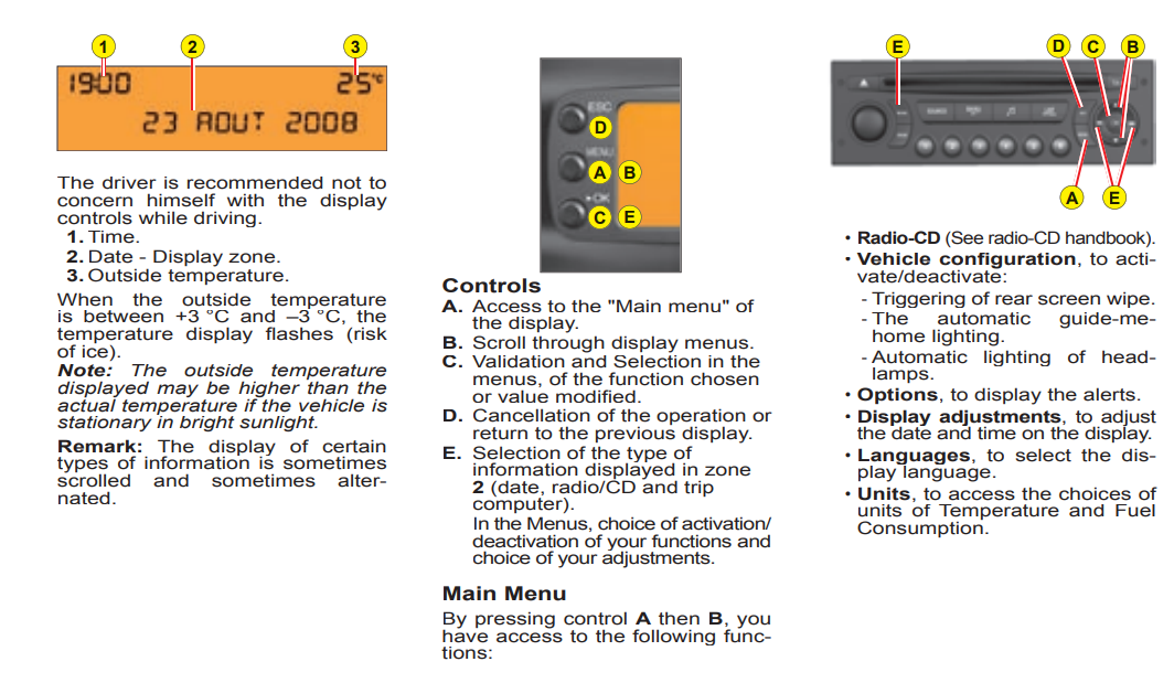

Hello,
Before my car went in for a service, the screen displayed Time, Date, Temperature and the music station it was tuned into.
After the service the date and music station had disappeared to be replace by 99999km.
Can someone tell me how I change the screen back to how it was prior to the service. Try as I might I can't do it.
Thanks in advance.
x 6954
Re: After car service, display has changed
You'll need to consult your owner manual, as it looks like they may have disconnected the battery and / or changed the display, but if it's the display I think you have, this is the section you require to set the display back to how you want it:
