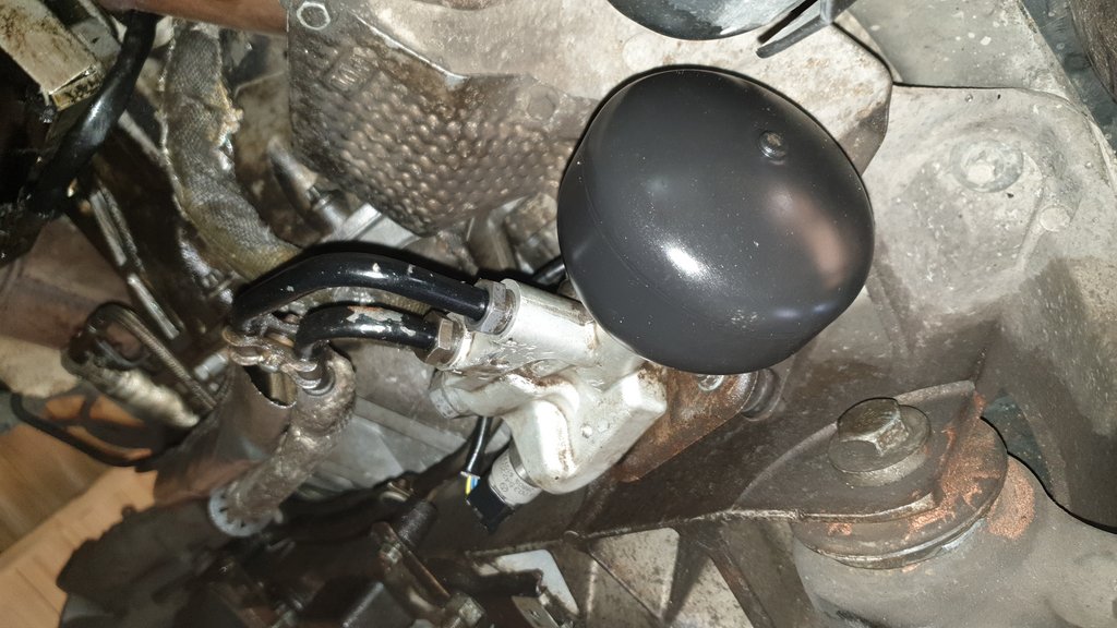

So then the Hydractive suspension, sitting high at the front...
The symptoms were rather odd.
- If I set the car to height 1, both the front and rear go all the way down.
- If I set the car to height 2, the rear raises a little, then the front goes sailing all the way up to maximum height.
- If I set the car to height 3, the rear raises a little more, and the front stays at the highest setting.
- If I set the car to height 4, the rear goes up to max, and then matches the front.
After a kind suggestion from Marc, I cycled the car up/down a few times (about 10 times I think) but the above seems pretty consistent.
So I did a bit of research... and I found the Citroen C5 workshop manual is here:
https://www.allcarmanuals.com/data/file ... 7-2017.pdf
At first glance there is no index, and no search function. But the PDF actually has bookmarks to help you navigate to the bit you need to.

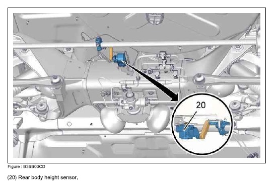

These are the main Hydractive components at the front (4 cyl models):
This is the same for the rear (4 cyl models):
Once again Marc has been incredibly helpful; and I see that's a trend on here :mrgreen:
His thought first ran to the front ride height sensor, and my own thoughts were that since the suspension seemed to be going up/down very well it had to be a sensor issue of some kind.
So after a bit of googling, I found that the sensor part numbers are:
- Front 5273 J4
- Rear 5273 J9
I found a brand new genuine one on Ebay, and I ordered that. I also ordered the Lexia (sounds too much like google Alexa for my liking :lol: ) so that I can set the suspension up afterwards.
So fingers crossed, after a bit of work, a cry, lots of tea and maybe even some colourful language... I may end up with a working C5 I can drive to work soon! :mrgreen:
