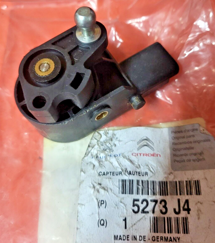

I am starting to see what people mean... information on these cars is kinda scarce...
I thought it could not hurt to get a sensor ordered, and I have Lexia on it's way so that I can set the height up afterwards. But can I find the sensor part number?? - Sadly not...
This below seems to give me the main suspension components, for a 4-cylinder car like mine. I can imagine purchasing and replacing those sphere's over the next few months might be good preventative maintenance; similar to what I have done on my Mercedes CL500.
This looks handy for the rear sphere's too... and I have snaffled this picture aside for future use.
But the pesky front ride height sensor is not shown...
...ah but then I found this
Note: 6 cyl cars have a different image; this is for 4 cyl cars.
I have no idea what angle we are looking at here... I am thinking in from the top of the engine bay. I can only guess this part is best accessed from underneath the car, and it looks to be on the left hand side of the car (the passenger side on a UK model like mine).
Then for reference this is the rear sensor.
The manual then goes on to tell me all about topping up the fluid, setting up the ride height etc. but no mention of part numbers.
Can anyone tell me the part number for the front sensor please?
...and better still is there an online resource to find out part numbers?

MrBerlingoC5
- Posts: 8
- Joined: 12 Jan 2024, 15:53
Re: Citroen C5 X7 - Pesky Hydractive suspension
How did the luck work out?
I also find myself searching for this part number now so I'm curious if it's the correct unit? And indeed if it solved your issue.
