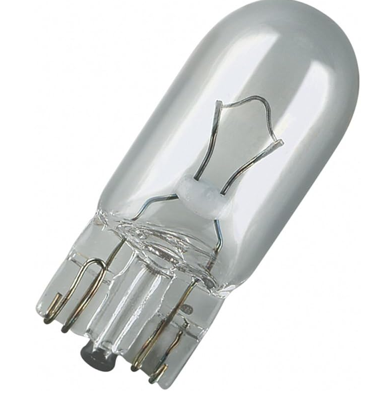

1) These are simple 5w5 bulbs.

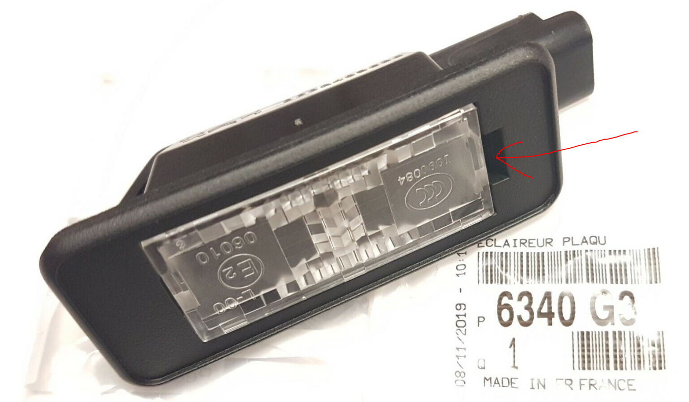

A small flat screwdriver to remove the clear lens as shown and replace bulb.

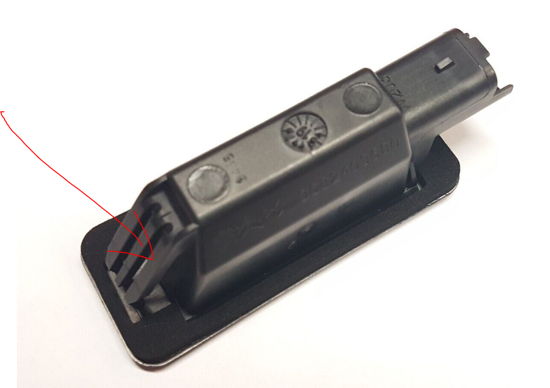

2) Using trim tool or flat head screwdriver angle out the complete bulb housing after depressing in the retaining clip and replace the whole unit:
