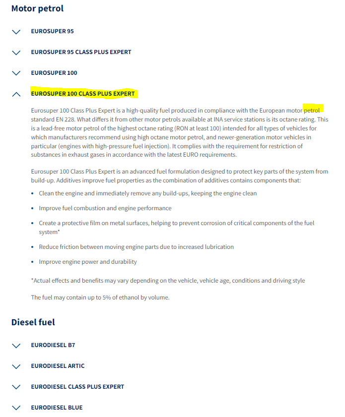

Regarding the additives, I didn't add anything extra I just used the fuel on the gas station with already added additives.
This is what I found about the fuel info on the gasoline supplier website
Also, the car is still driving in great condition with no issues or symptoms.
EUROSUPER 100 CLASS PLUS EXPERT
Eurosuper 100 Class Plus Expert is a high-quality fuel produced in compliance with the European motor petrol standard EN 228. What differs it from other motor petrols available at INA service stations is its octane rating. This is a lead-free motor petrol of the highest octane rating (RON at least 100) intended for all types of vehicles for which manufacturers recommend using high octane motor petrol, and newer-generation motor vehicles in particular (engines with high-pressure fuel injection). It complies with the requirement for restriction of substances in exhaust gases in accordance with the latest EURO requirements.
Eurosuper 100 Class Plus Expert is an advanced fuel formulation designed to protect key parts of the system from build-up. Additives improve fuel properties as the combination of additives contains components that:

I screenshot the car vin number here http://prntscr.com/6SocvPA6nQz
if its not visible here it is VF3**************[VIN obfuscated, can be read by forum staff]

Well I'm not surprised you are having issues if you have put that in your engine - it is classified as PETROL not diesel
I think if this is the case, you seriously need to have the fuel tank drained.EUROSUPER 100 CLASS PLUS EXPERT

Oh wow, that would definitely be an issue. If in doubt of what your vehicles fuel is, grab the diesel pump first as it/should be impossible to put diesel into a petrol engine car as the diesel pump is larger in diameter preventing it going into a petrol engine.

I must be under heavy stress
) .. Sorry I misplaced the correct info on used diesel.
Also after refueling, I drove the car some 350km, and the performance was great, much lighter, and more responsive on the gas pedal.
Do I just need to refuel Eloy's fluid, is it just a coincidence that this has happened after refueling on the gas station, I don't know..
Here is the correct info on used fuel, below;
Eurodiesel Class Plus Expert is a top-class fuel based on high-quality fuel that already meets the latest European standards for diesel fuel, and is enriched with additives. This fuel meets all quality requirements in line with the European EN 590 standard and is primarily intended for vehicles with highly efficient catalytic converter systems for the reduction of harmful exhaust gas emissions. Eurodiesel Class Plus Expert protects and maintains engine power with its active protection.
