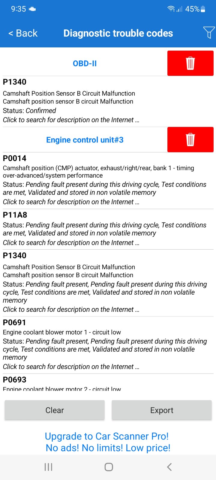

Hi, I've been trying to fix my Peugeot myself and need some help with the codes below.
The engine light came on while driving and when I plug in my diagnostic reader I get the following codes. I've changed the camshaft sensors to new ones but the code P1340 is still showing for some reason. Also, I've changed the solenoid valve at the front of the engine. I've now got a new code P0691 Engine coolant blower motor 1 - circuit low and motor 2 - circuit low.
P1340 Camshaft Position Sensor B Circuit Malfunction
P0014 Camshaft position (CMP) actuator, exhaust/right/rear, bank 1 - timing
over-advanced/system performance
P11A8
P0693 Engine coolant blower motor 2 - circuit low
