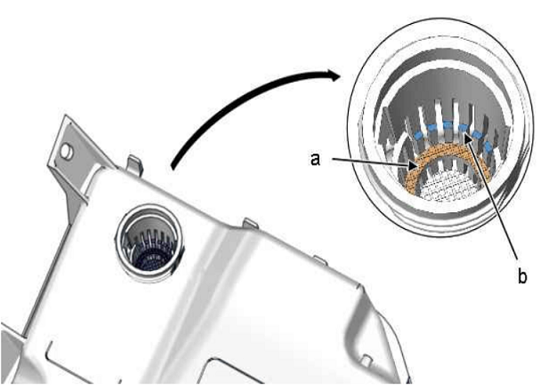

First, bottom out the suspension. Turn the engine off. Now, undo the cap to the LDS reservoir. You will find that there are slots in the neck of the reservoir. The 'tall' slots denote the maximum level, while the 'short' slots are for the lowest level.

The level must be between the 'a' and the 'b' marks as shown below on lowest suspension setting as mentioned. Make sure you use Total LDS Fluid or Total Fluide DA only which is an orangey brown colour. Don't use LHM or anything that looks green.
