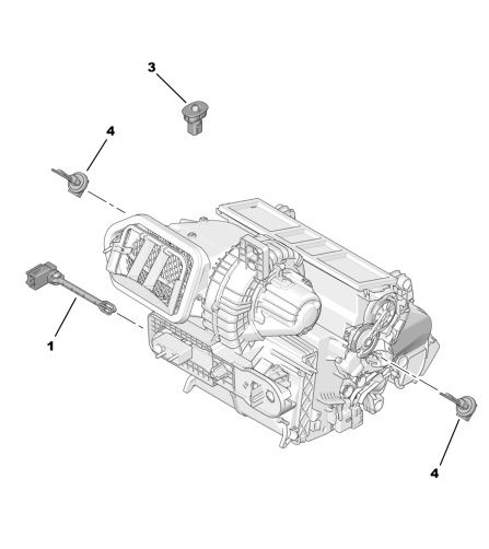

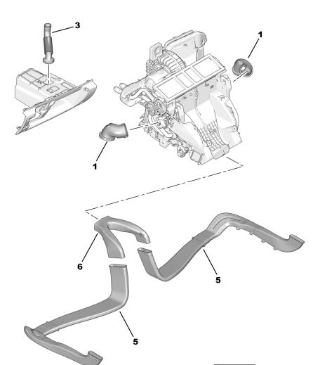

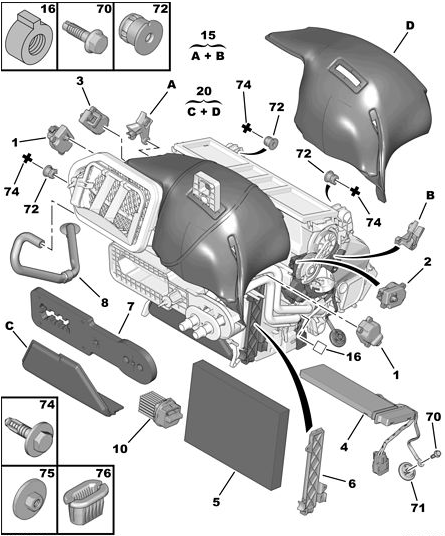

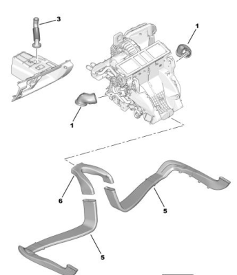

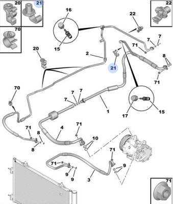

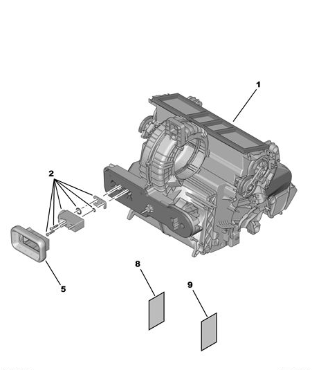

can you spare a drawing of the inner AC/Ventilation system ? are these part accessible without taking out the entire dash...?

Not really going to help - which is why the 'sniffers' they use along with some dye in the system can detect / trace leaks. They can probe inside the dash vents to detect for gas leaks - whilst under pressure. I would of thought thought that there would be plenty of A/C specialists over there with the weather being a hotter climate.

I suppose getting to the evaporator requires dismantling of the dash "big time"?
- x 6955
Re: AC refrigerant leak - Peugeot 3008 2016
Yes, but may not even be necessary!

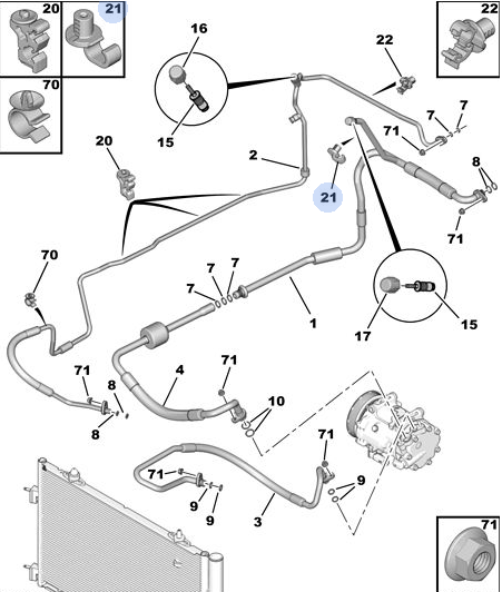

You need to pressurize it to about 100psi. Or at least to as high as you can. The higher the better. Ideally you need to pressurize it with dry nitrogen. If you pressurize it with air you MUST change the descant pack in the receiver dryer. Air has moisture (water) in it which forms acids when combined with synthetic gasses (R134a, R1234YF, R12). The "vac-down" (when re-commissioning the system) should also be extended to remove as much moisture as possible.
Warning, danger, do this at your own risk!!!!! The system can be pressurized with LPG (barbecue gas). At 30'C LPG has a vapor pressure of 160psi. So you don't need much to get to 100psi. OH! and for you snow flakes out there, Yes in some Countries and states it is legal to use LPG mixtures (R600a and R290) as a refrigerant in vehicles!!! But do it at your own risk...right?
Fortunately the evaporators in the dash don't tend to fail that much but you could look for oil in and around the water drain under the car.
Look for areas where the aluminum and flexible pipes could rub on another part of the car. Concentrate on joints. Joints that are bolted together. Joints that are crimped together (like where the flexible pipes are crimped to the aluminium pipes).
The main shaft seal of the compressor (behind the clutch) is a common failure point.

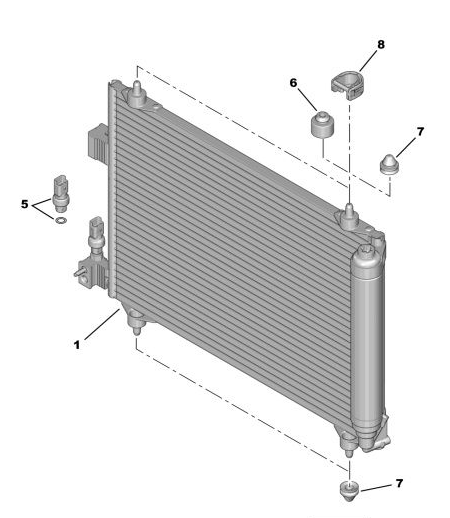

The condenser at the front of the car is exposed to rocks and the flexing of the chassis. Look for dints from rocks and cracks from stress.
The schrader valves of the service ports (usually capped) are another source of leaks. Remove the caps and look for oil.
I use a mixture of water and dish washing liquid. About 20-25% dish washing liquid to water. Use an old "squirt" bottle to apply it LIBERALLY to all the places mentioned above...and wait and watch. Bubbles may not be big or appear instantly.

On our C5 the air con leak was the front condenser, it was not much of a leak but was found by the uv dye put in by the garage to show up leaks but without this nothing could be seen.

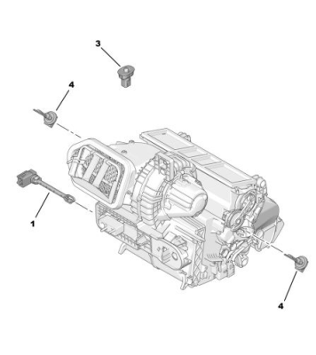

Hi, i have no luck in retrieving the removing-refitting evaporator sensor instructions (my software crushes all the time) - can you share these?
thx
- x 6955
I'll put a guide up in the members Resources section shortly. Check back here in 10 minutes or so and I'll provide a link.
