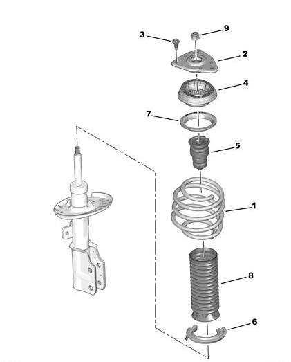

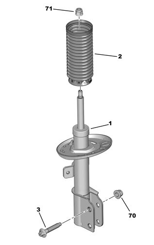

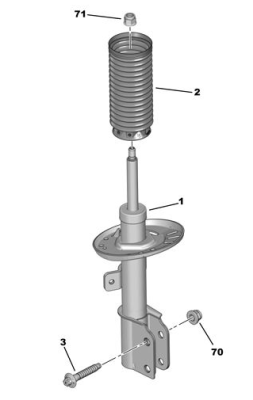

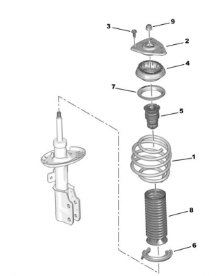

They just have springs and dampers like any normal vehicle (see below), but there is a base damping and a variable damping version (active scan suspension option) with AMVAR. Nothing too complicated, but there are body height sensors and a small ECU. Basically the camera looks ahead at the road on the active scan version and uses this info and that of the 4 height sensors and 3 accelerometers to make small adjustments in the damping.
I suspect as these are like most other springs and dampers with some modifications on specific versions, that they can just wear out like any other damper and spring that needs replacing after time.
